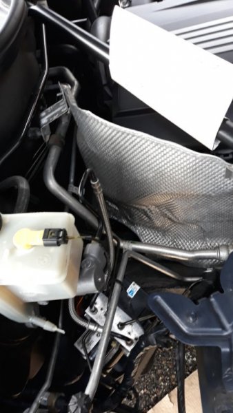

So jacked the drvs side up removed wheel and wheel arch liner to get better access to the ABS pump/module. Numbered the 6lines up took pic and made drawing of unit with pipes attached. Found half a wooden broom handle and propped brake peddle (pressure on) against drvs seat, easy with elect seats to get the right pressure on the brake peddle. This I was told (by @t-tony ) would push the survo piston past the replenish port holding it there( till repaired one fitted) so as to isolate the reservour thus no need to lose all the very new fluid. Less messy, only a few drips from the pipes getting unit off.
Unit with cushioned bracket still attached removed through the wheel-well.

Fitted abs pump/module to bracket and bolted it in position. Then with 11mm bleed spanner fitted five out six unions and as usual being fine thread into alloy pump block number 6 just wouldn't start to thread in properly, now everyone knows what a real ba-----d this could turn out to be if it cross threads. So I unbolted the unit from its mounting and about 1hr later with absolutely raw fingers got it to thread properly. Bolted it all back onto mounting and found I'd lost one of the three bracket bolts, more time wasted looking for it. Never found it but did have same size thread bolt too long so used a nut to space it out. It's under pump and not visible when the wheel arch liner is back on.
