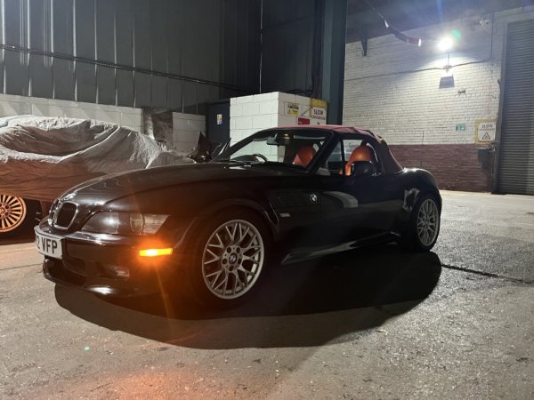

I tried on a set of Style 66 I had laying around from one of my old e39's - I love the rear fit, however the fronts are a tad too wide.
Will be on the lookout for a different set of wheels over the next few months, quite fancy a set of wheels with a nice dish.
