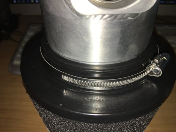

Cone air filter arrived today, and a perfect fit to the MAF housing! Cost the princely sum of £22.50 :D. The benefit of the dry foam cover is that it can easily be washed, and doesn't need oiling - so no potential mess accumulating on the MAF.
Forgot to mention the MAF housing was £65, with £18 delivery (hammered by the $ exchange rate). Sadly customs wanted £13, and then Royal Mail also wanted £8 to push a card through my door telling me about the £13 :shifty:
Total cost so far is £126.50, which is around £300 under the cost of importing an AFE induction kit. So far it's a bargain!
Next stage is to see if it will all fit in the space left by the old air box, which should happen later this week. I have a slight suspicious it's a bit longer than will fit, but can always look to cut down the MAF housing a bit.

I have a K&N cone filter on mine. It didn't quite fit so I cut some rubber into a strip the corect width and length. Warped it round and then when the jubilee clip tightens up it makes a perfect seal.

only problem with foam filters is when the degrade you start pulling bits of foam into the engine
Yeah, but at £22.50 a go I can change it every oil service and still not break the bank. I may buy one of the other types of cone at some stage to see if there is any difference between them. Obviously won't be a scientific test.
