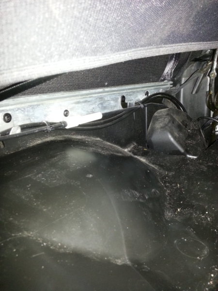

Due to the bad bmw design. roof motor failure is a common problem as they tend to sit in water when the drain holes get blocked.Resulting in extortionate costs of replacement of the motor.So to overcome this I've had the motor relocated into the boot . where ive got access to it .Why they put it down in the rear wing I'll never know.In the Z3 its sorted .So I went up to Durham this morn and had it sorted cost £120.only issue is the carpet used to form a cover is a different shade .But I can live with that .
