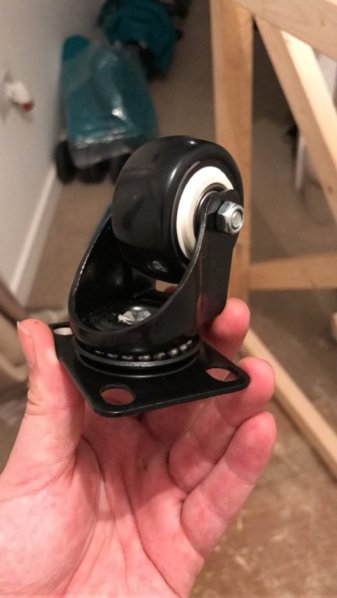

All that was left was to fit the wheels:
(I had to drill extra holes in order to secure, as the fitting brackets were slightly too wide for the base of my stand.)
