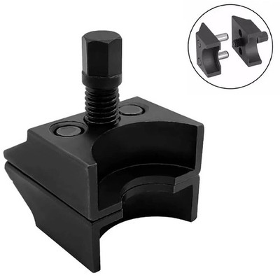

Also important to ensure front struts slip fully down into the front hubs, refreshed a 3.0l a few weeks back front and rear shocks then found out the ride height at the rear was higher on one side, not really noticeable visually but a tape measure confirmed the mismatch. Changed the rear shocks again but still the same. Turned out it was one of the front struts not fully down in the hub clamp causing it. Car drove fine so all our attention centred on the rear until we found the mismatch on the front. Since that I ensure that I use a spreader tool on the hub to ensure the strut drops cleanly into the hub and once the top mounts are in tighten the clamp bolt with a jack under the hub and double check it when the weight of the car is back on it.
The spreader tool is also good to use when getting the strut out of the hub, makes it very easy.
