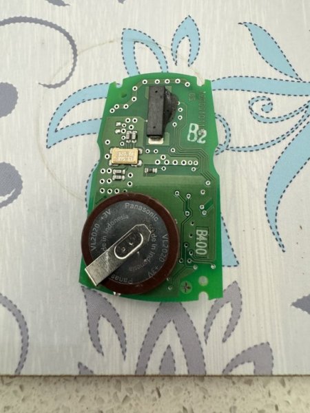

Not sure if this helps anyone but my second key was dead and wouldn’t recharge.
I bought a new replacement rechargeable battery bmw button sticker and new fob, cut open old fob to take circuit out, melted solder for battery and pulled off, pushed new battery in holes and bent ends then re soldered, put back in new case and pushed together then stuck bmw sticker on and put the door blade in the new fob. All works perfectly now, cost £12
