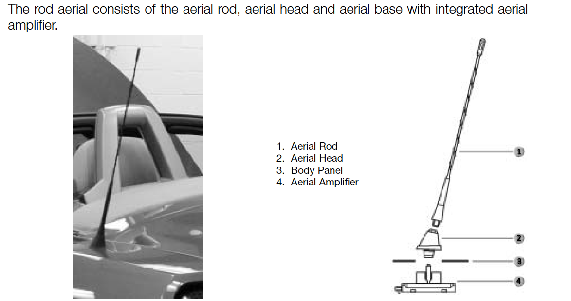

So I am thinking that the radio reception in my Z4 is not too good when out of town, in fact pretty dismal, a quick search brings up a guide in the resource.
https://zroadster.org/resources/how-to-locate-your-antenna-amplifier.38/
I found and downloaded a PDF detailing the layout of the aerial system, talk about complicated!
Has anyone on here had any experience of this repair?

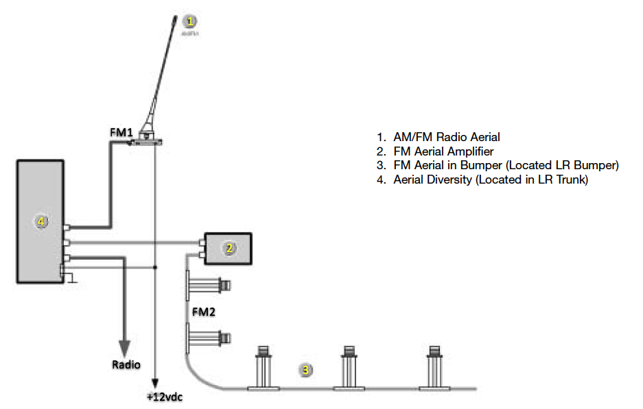

So an update on this issue, Looked at the wiring diagram, the FM on the radio has two sources for reception FM1 & FM2, by process of elimination through the disconnection of various coaxial cables in the boot, I worked out that my car was only receiving signal via the FM2 (bumper) aerial.
E85 Aerial Wiring Diagram
Replaced part 4 below
A trawl on eBay showed a second hand unit for sale, a few days later it arrived and the radio reception is now considerably better. Happy Chap :)
Was the most likely cause. Pleased you got it fixed.
How much was the replacement?
Not too sure why it failed TBH, quite a lot of circuitry in the small amp, I'll put it down to age. Replacement cost £20.00.
Redline
Mar 10, 2015
208
Nuneaton
E89 20i msport
Most likely to be a capacitor that has dried out. It's quite exposed there taking a lot of summer heat.
