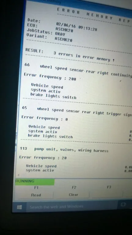

Well a little knowledge is a dangerous thing. Read the codes and got read out below
First stupid question, which side is the right?, not suggesting I need to chalk a L or R on tyres always, but do I look from the front of the car or back
Second are all the faults triggered by the sensor or are there 2 distinct issues here, many thanks Simon

Looks like a sensor issue is triggering the codes, clear them and re-visit in a week or two, see what has re-appeared, I note from the errors above that fault 2 has no error frequency at all.
New sensor fitted, delphi one, not the same shape as the bmw but after a few starts and drives, lights have gone whoopie, thanks
