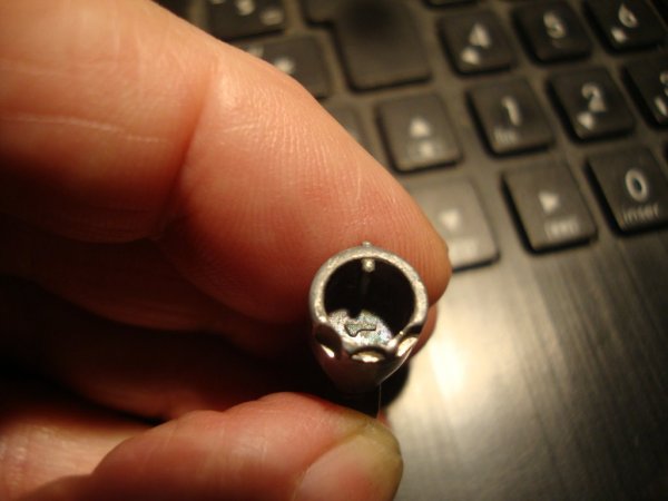

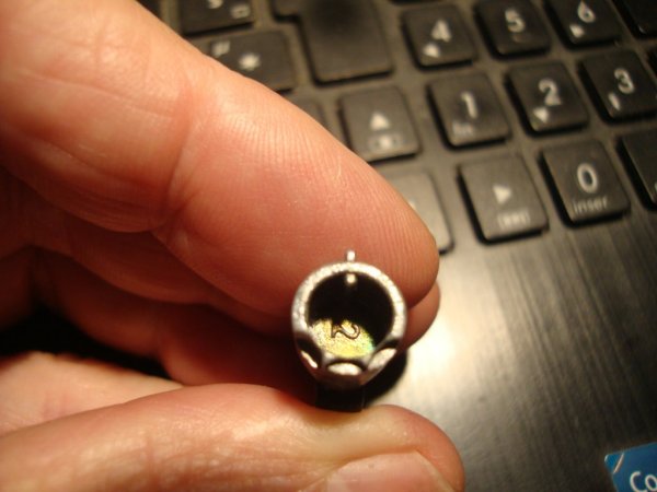

The other reason for this post is regarding the entries above regarding the siren key. I have two and looked at them this evening carefully. They appear to be identical (or perhaps almost identical) and both seem to turn the alarm setting off and on after a little fiddling but, inside one of them is the number 1 and inside the other is the number 2. Can anyone enlighten me on that? Are they keys 1 and 2 for the car and the same or are they slightly different and maybe only both work because one is a little worn? Any thoughts would be appreciated. Have attached 2 photos which may help.
If you look on the lock on the siren it will have a number. I believe that this number should match to that on the key and that would be the key to use.
My lock has the number two on it. I couldn't find anyone with a key to be able to test this out.

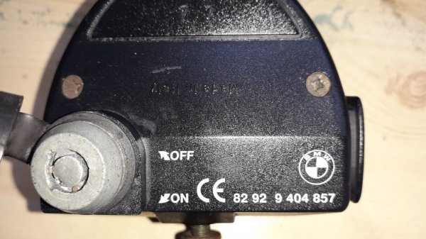

Can anyone confirm if this siren is in the on or off position, please. I am trying to get my alarm system to work, so just need confirmation. I tried Tony's suggestion to turn just the inner, but it isn't that simple, never is ☹️
