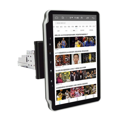

I'm settling on something like this...
However, although all 1-din fitting, they don't seem to come with a cage/frame. Just some brackets.
The sides look like this;
I just can see how that would fit without a normal cage/frame
I've even seen in the reviews a pic of one installed in a Z3?!!
(it was just a pic in the review, so I can't even ask the owner!)
Anyone got a clue? I'm just very apprehensive to order and then find I can't get it to fit?

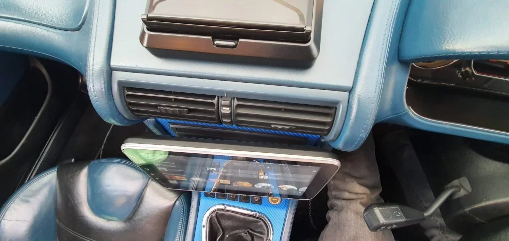

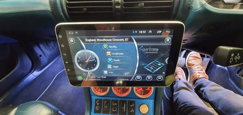

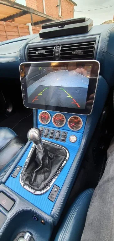

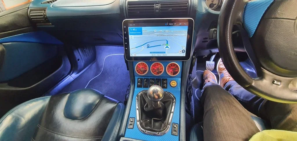

so I checked today and it is in a cage:
this is covered by the trim that comes with it:
the screen and holder is slotted to allow different heights:
It has two clasps that you slide outwards to adjust the height, and a ball fixing that allows it to be swivelled.
Now I am not sure if it came with a cage, or I just used the one from my old Pioneer unit, but either way it is doable and it locks in place.
I tried to remove it with the two Pioneer keys I have, but it wouldn't come out,
So I had to stop there and take the missus out instead...... !
