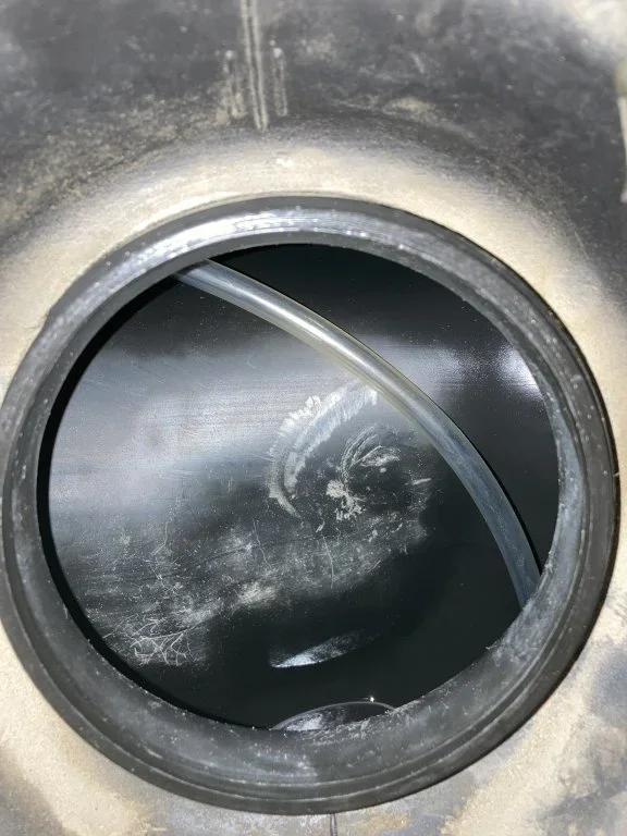

The rubbing on the back is due to collapse of the tank due to vacuum when running the tank to empty (as the vac release mechanism on all our cars fails).
I was wondering about that, on my car the collapse is now “permanent” and I’m wondering if I should be fixing the vacumn issue, and how to do that. Something to do with the charcoal cannister? And a valve?
I very much doubt it’s permanent. It’s a function of vacuum and outside temp. People have reported that there is an anti vac valve that has failed. I did not go that avenue (did not find accurate info)

By permanent I meant if I fit a unmodified pump assembly the sender section will foul the rear wall of the tank, so it appears to have distorted and stayed distorted.

How are you sure that an unmodified pump scratches the back of the tank? I assume that the tank retreats to its original position because once the vac is released it can be filled with the full 50+ litres of fuel.

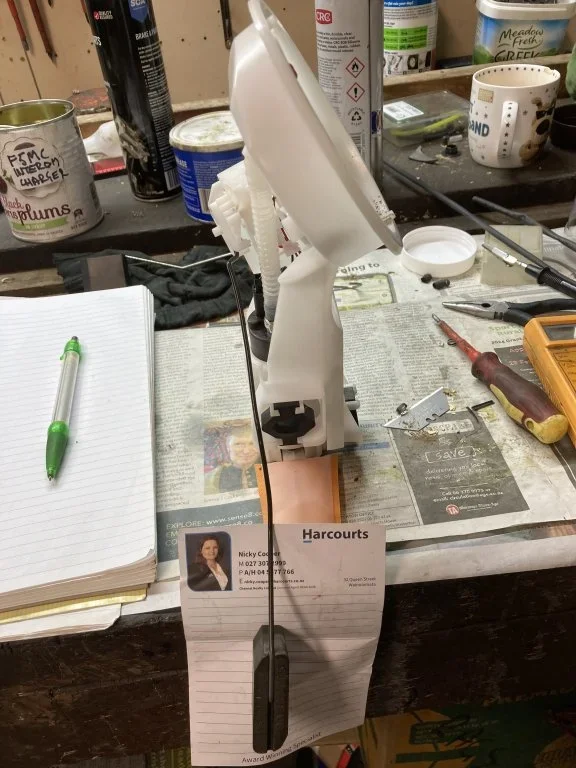

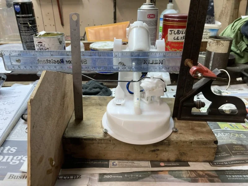

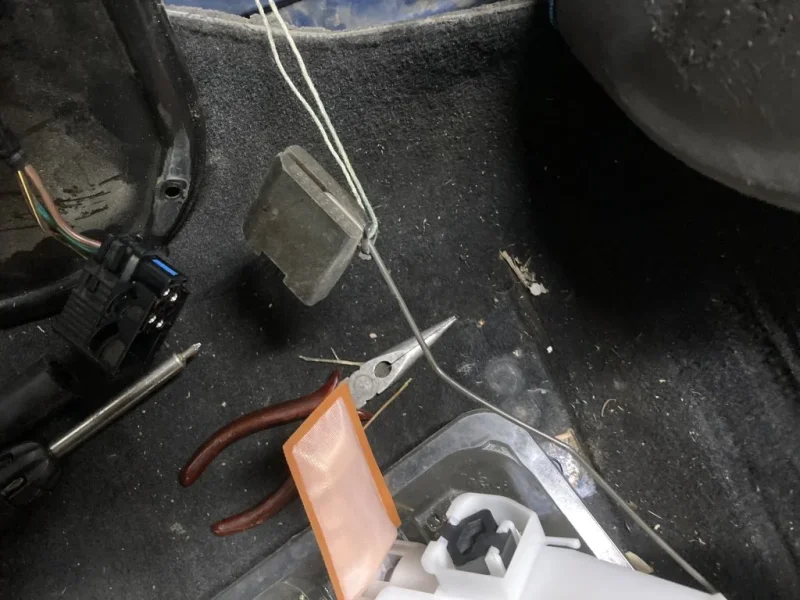

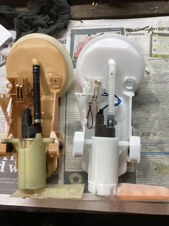

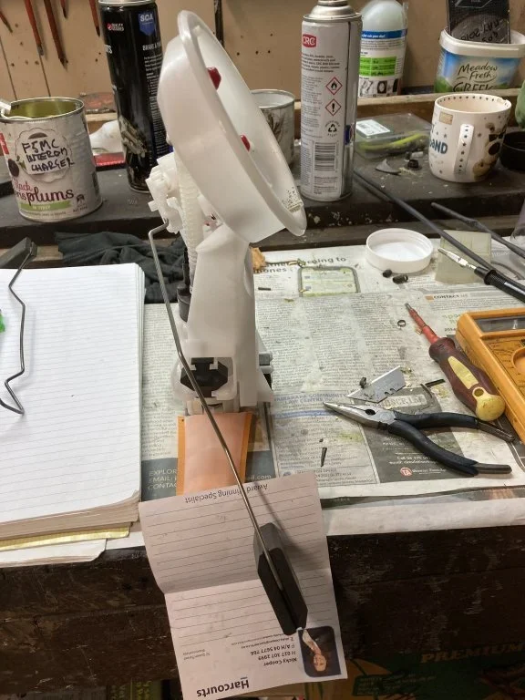

During test fitting both the oem pump and aftermarket both fouled the tank, and failed the “pull up with string” test, so 99% sure,
I also went to great lengths to measure the protrusion of the sender unit and space for it in the tank, I made a approx 4”x3” cylinder of cardboard that replicated the size of the pump assembly and put cling film over one end and trial fitted that in the rubber gasket mounted in the tank and it was clear the tank impinged on where the swivelling part of the sender needs to go. The clearance I created is still only a few mm so I doubt the fuel capacity would change much due to the wall moving enough to jam the sender.

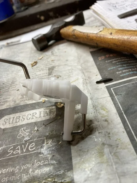

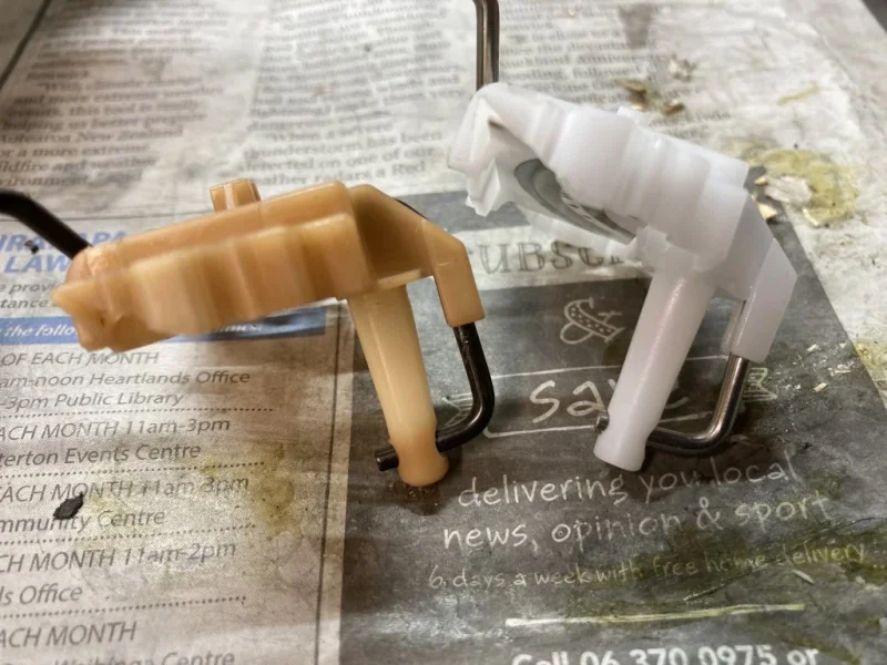

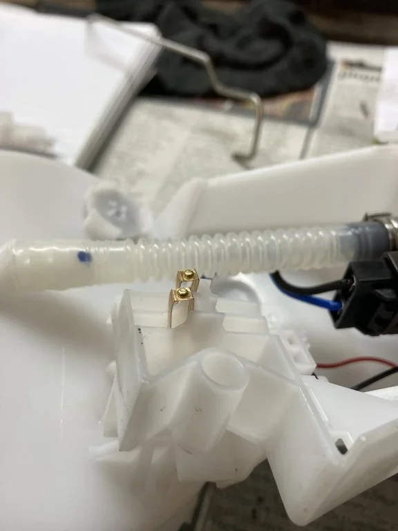

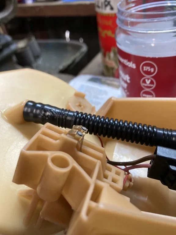

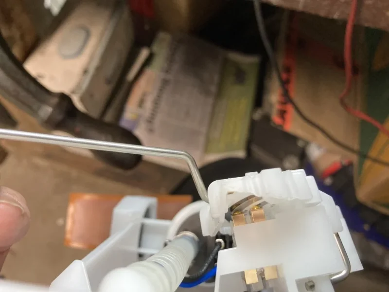

Before doing the above I established no amount of bending the float wire resulted in the passing the “string” test, and due to lots of trial and error 🤬 I have now found the best way of bending that wire (see pics), so the wire clears the quite narrow gap between front and rear walls, and that the float does not get stuck on the ledge on the rear wall when the tank is full.
There are several issues that result in the sender not working, impacting the tank (regardless of a vacuum) is just one of them. I am still pretty determined to remove any possibility of a vacuum occurring by some mod to create a simple vent. I am pretty fed up with draining the tank and fitting and refitting the pump assembly 😡😡😡 I don’t want to have buy another pump and fit it.

Can you clarify exactly which pic is the optimal shape of the float wire that clears the wall? I see 2 pics and they look different.
These 2 pics show the end result of bending, it’s difficult to take a pic that clearly shows the bend, the first adjustment needs to be made to the “twist” in the wire right next to the sensor, to make sure the wire does not contact the rear tank wall (noting my other comment about “feeding” the wire through the clip in the sender rather than clipping it).
