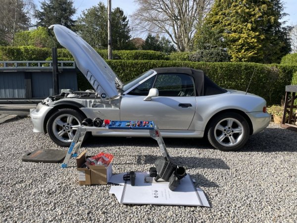

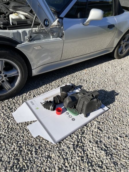

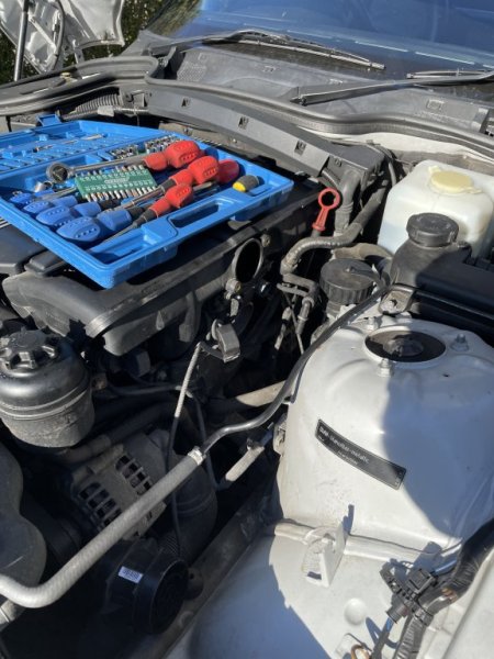

Apologies, however I have a long overdue update for this thread!
Stripped the intake hoses, DISA valve and idle control valve off for a check and clean up.
Found a very slight split in the upper intake hose where it connected to a plastic elbow. Also the 3.5 mm vacuum hose had seen better days.
Additionally the DISA valve isn’t holding any vacuum, and doesn’t actuate when 12 volts is applied to the terminals with a power probe. Hence new parts ordered and awaited. Hopefully this will see an end of the intermittent engine management light appearing. The car seems to have been running fine but from what I’ve read there may be a perceptible improvement in performance with a new DISA fitted……
Update and photos to follow once the new bits are fitted hopefully this weekend…….

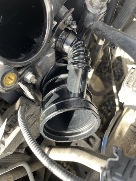

So, replacement DISA valve fitted, along with new Febi intake hoses. Also established that the MAF sensor was damaged and not functioning correctly hence that was replaced also.
The car drives and performs very well, however………the engine management light still popped up after a day or so. Showing fuel trim codes.
The car seems to be running perfectly however next move will be a smoke test and possibly change both oxygen sensors. I’m sure that I’ll track down the cause and get it sorted soon!
