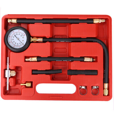

Thanks for your advice. I bought the pressure gauge but it is to ckeck the pressure of combustion chamber and did not hit to the Schrader valve. I tried to search the adopter but can not find it. Is it a special adopter that I have to order to BMW?

You bought a compression tester for the engine cylinders, you need a fuel pressure test kit that connects to the shrader valve on the fuel rail. Kits on ebay at various prices, most are from China so delivery can be long.
Thanks very much for your advice. I could order the correct tester.

Make sure that the tester has a Schrader valve adapter. Many do not have this adapter. You will need it to connect to the fuel rail.
