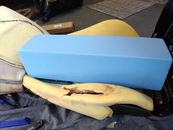

I have had all the parts to complete my z3 seat reconditioning and heated seat upgrade sitting in the garage for weeks ! I have finally plucked up the courage to get on with it. So hear goes.
Step 1 remove the leather seat covers. OK so I was surprised to find that the leather was glued to the blue parts, didn't notice that in the other blogs that I have read, but as we all know every z3 was built differently!
Pictures of seat base and back after removing covers.
Bolster will need rebuilding
I have read articles that say you can rejuvenate foam using a steam cleaner, so let's try it!
Before steam
After steam, the picturesmight not do it justice but after treating the whole base foam it was about 10mm thicker! I wonderhow long it will last!
No going back now I have cut away the damaged part and glued in place the new foam.
Maybe a bit extreme, I'll cut it down to size!

And no hog rings ! The new heating elements will have to be glued in place and then I guess I'll have to glue the leather to the heating element! I don't like that idea but don't see an alternative as without the glue the seat leather will not be tight. But first I have to shape the new foam.
Lots of people just use zip ties. Fyi

I expected to find either hog rings or cable ties but there weren't any, it appears that my seats don't need them!
