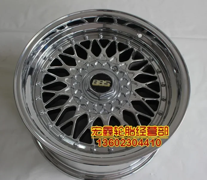

The front offset calculation cannot be right, i think all wheels must be 9". At 57 i think it would rub no matter what tyre, re-check before ordering wheels, are there no markings on the wheel on the inside, they should at least have the rim width on them, can you take a photo of the inside Pete? Looking on this web site, it does not look like the M3 had an offset that high http://www.gruppeb.com/BMWwheels/
Also don't forget the offset is specific to the wheel style as well, so those BBS Chromes may be different to what you have, drop BBS a mail, i am sure they will give you the specification required
