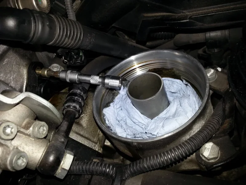

3. Ball up some paper towel and fill the filter bowl with it to prevent anything going into the engine, this includes the centre part which I had already unplugged to rebuild.

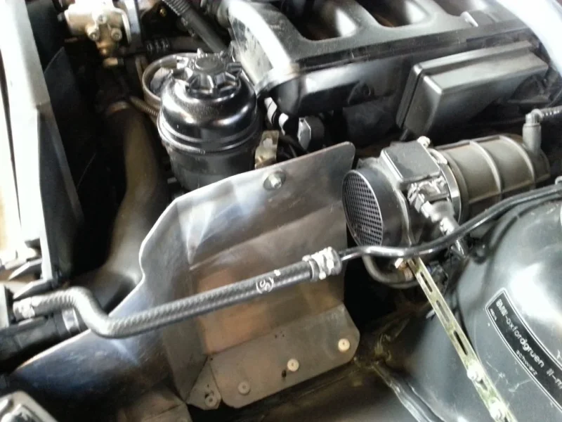

9. These are the only tools needed to do this relatively simple job.

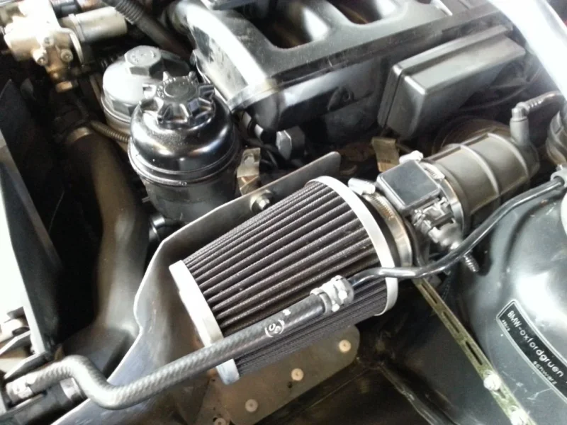

A 36mm socket to remove the oil filter, a small pair of grips to remove the Vanos solenoid. Some 1/4" drive socketry , a 7mm socket for the hose clips to remove my cone air filter to access the cable plug and a 5mm allen socket for the sensor securing screw and a couple of extensions.

Another tip - When I changed mine I also removed the air intake pipe between the air flow meter and the next joint towards the inlet manifold. This gives better access to get your arm in and remove the sensor plug from the socket.

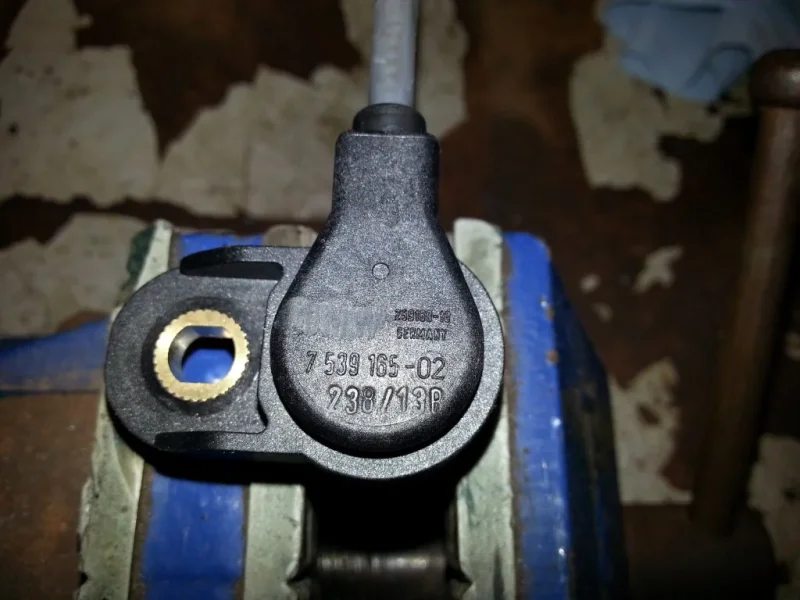

Hi Bryan, I was led to believe that the one I fitted (just over 1 year ago) was an OE quality item but when I removed it, it appeared that was not the case. However the replacement one was obviously a Bosch item with their trade mark obliterated.
This is the one I removed.
This is the one I put in it's place. You can clearly see that it's Bosch item, and if you google the part number you'll see that's the case.
