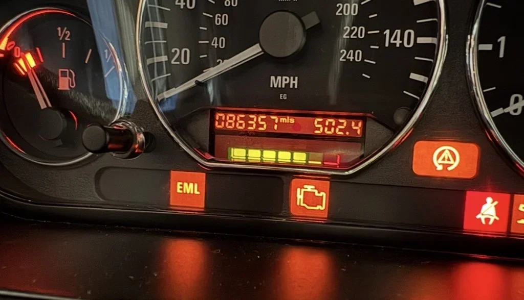

@Harris ..many on here have the Creator 310+ ..about £50. It does most things. Also what did you mean by Not EML …that stands for Engine Management Light 🙂

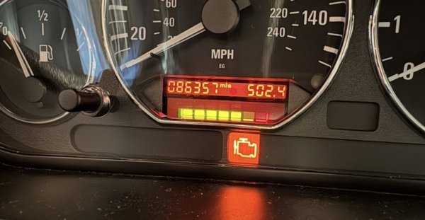

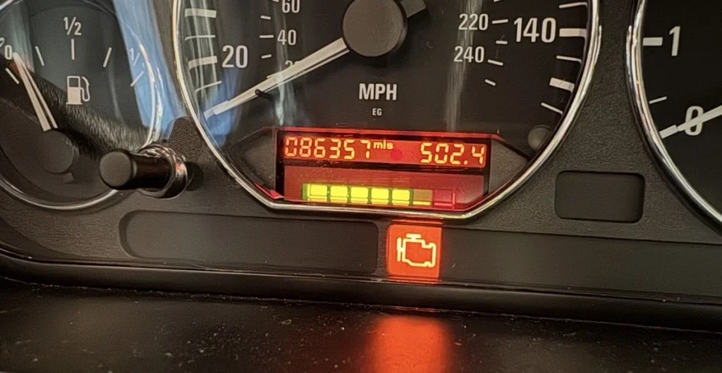

Good question, I might be confused but I have a EML light and a light that looks more like an engine. It’s the engine that is staying illuminated.

I had a few codes but cleared them. The only one that has come back is P0174 which is suggesting running too lean.
