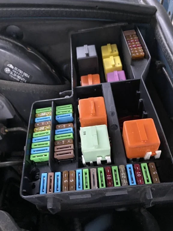

Two very minor issues which appear to be power related however in both cases the fuses appear to be fine.

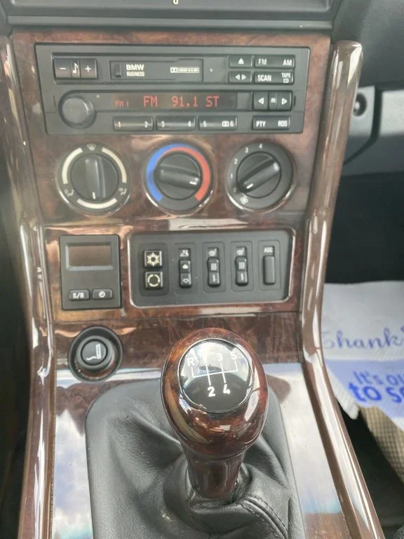

1. On Board Computer is blank. The previous owner recalls it to be operational.
2. The side view mirrors to not appear to work via the switch in the drivers door.
I have recently had some work done on the car to certify it to local standards and address issues related to lack of use, brakes, calipers, rotors, coils, plugs etc. Some sensors and bushings.
Aside from fuses is there anything else I should be checking as the root of the problem. A common cause?

If the car has been standing for a long time and the mirror switches not used then I would remove the switch and give it a liberal dose of electrical contact cleaner while operating the switch and see what happens. Do the seat motors all work ok? These can be an issue when they have not been operated over a long spell.

Hi 1998 2.8 computer died when it was laid up for 12 month the display would only show four lines down the middle i had to replace it with a second hand one

Remove the computer and unplug it from rear allow 24 hours to mother warm and plug it back on it should resert
Ref the mirrors, it could be the case that the mirror wires have not been reconnected when removed at some point.
