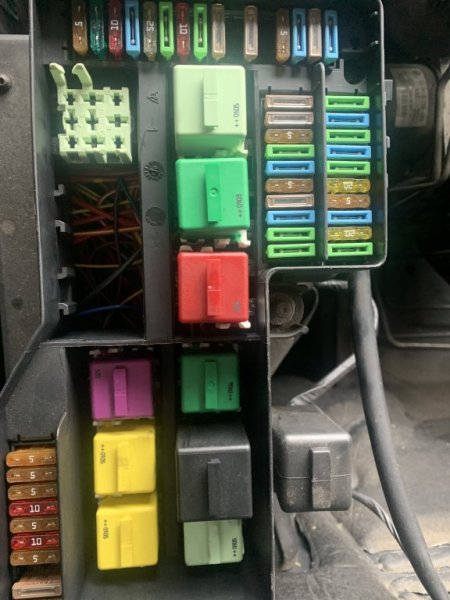

The first problem I am having is that I cannot work out which the "Main Relay" actually is. I have found loads of diagrams on the internet, but none of the relay arrangements appear to match mine exactly, and all seem to be for earlier models. I have attached a photo of mine.

Download the manual from the Resources Menu at the top of the page
Fuse Box Layout
Link to Electrical Trouble Shooting Manual
Have you taken the Idle Control Valve off and cleaned its internals with some carb cleaner, they do get gummed up and stick, worth cleaning it to see if that makes it better. Avoid resetting the idle speed with your scanner until you have tried cleaning it.
The Main relay I think is the one that controls Terminal 15, main ignition circuit, try another relay of the same type in there and check for crusty green terminals. Clean all connections.
If your 2001 1.9L Z3 has the M43 engine, than you need the electrical trouble shooting diagrams for 2000 Great Britain. They are the only ones to cover your engine and are in the "Resources" section of this forum.
The main relay main be referring to the DME Relay (K6300), which is the main relay for the car. It is located in the Right hand side black box under the bonnet/hood. There are location diagrams in the back of the electrical trouble shooting diagrams to help you find stuff.
Thank you! It is an M43. At least I now have the right circuit diagrams etc.
I tried swapping the relay, but it hasn't made any difference - the same error codes persist. I also recall seeing a reference to a fault on Terminal 30.
