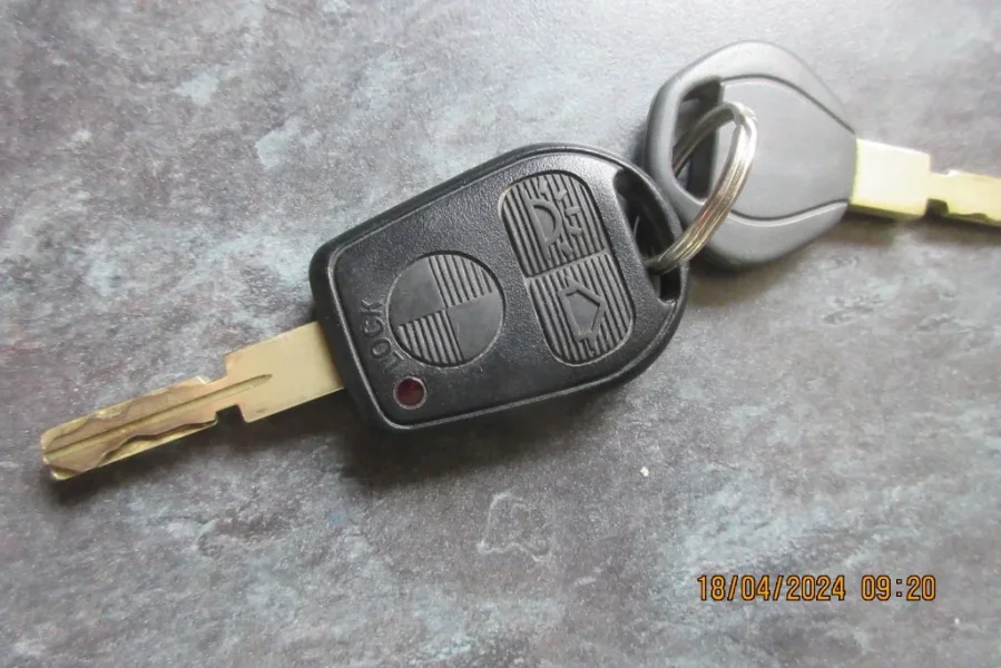

The remote access via my key fob is becoming unreliable in so much as it cannot always be guaranteed to lock/unlock the car - 1999 Z3 post facelift.
I have checked the fob(see photo) batteries and whilst the voltage was slightly lower than new batteries, I replaced them for good measure.

Do you have a spare key Brendan, and is it the same? I think I'm correct in saying that type of key "charges" in use.
