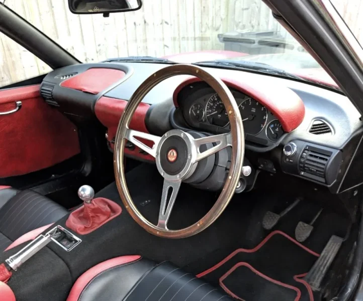

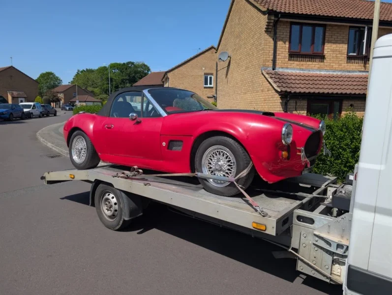

Hi All I’ve just bought this Nubodi kobra and I want to convert the dash to a flat style with analogue dials. I have seen an example on here but wondered if anyone could give me some pointers on how to get the top part. I’ve seen the tribute dash but I am after a flat front. If I cut the old dash back to the vents I am guessing I will still need to put a curved top in place before I mount the front dash. Is there a GRP moulded top around? Cheers Andy

Post a picture of what it looks like at present.
You need to be very careful with any new dash, as there is a LOT of 'stuff' in the Z3 that can't be moved, most notably the huge crash bar and the top windscreen vent ductwork/outlets. If you remove the vents it won't pass an MOT.

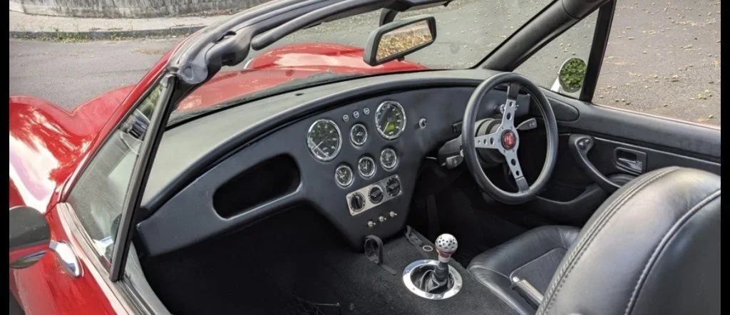

So it looks like 1st pic ie quite original and I am looking for something like 2nd pic. I like
The top piece of the second picture would need to be bespoke made as far as I know, as I don't know of anyone making flat topped dashes. There is a lot of work gone into that dash IMO.

The dash you are wanting is one of the best I have seen. Good choice.
The things that are hardest to reposition are the heater controls. It looks like the whole dashboard has been designed around their position - a very good piece of design, in my opinion.
It also looks like a very simple fabrication with one flat piece and one curved piece.
As said above, you need the windscreen vents, so you will need to butcher an original Z3 dashboard, but that's easy enough. The hard bit is getting all the curves correct, and those look pretty simple.
I'd start with cardboard, and work upto aluminium sheet, fibreglass and body filler. Aluminium sheet is an excellent material to work with as it is strong enough to hold shape, and is easy to manipulate. Fibreglass and body filler are excellent for making things look smooth.
It's not the one you are after, but here's some videos of how I made my dashboard...
