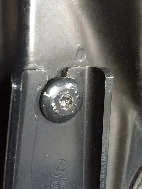

Rounded off a torx (T30) head screw, while removing boot hinge
I don't know if you fancy doing this but it's the method I use most of the time and I've done this a lot.farm machinery rusty nuts.If you still have a head on the bolt get a small cold chisel and tap it on the edge in the direction you want.sometimes it's a good idea to give it a tap in the wrong direction just to break the bind.use a good weight hammer but fairly gentle taps and you can use quite a steep angle.i can almost guarantee that this will work but if it doesn't it won't stop you trying other options.

I've removed the odd illegitimate little screw like your one by very carefully chiselling against the outside edge with a small sharp chisel.
You do need care here to chisel at a tangent . I find after a few good wallops I can usually get the blighter unscrewed.
I've not had much luck with the reverse threaded stud extractors and found the above more successful.

A good clout with a sharp chisel often does the trick.
Nice sharp chisel on the outside of the bolt creating a indent and tapped in the correct direction, you only have to move it a bit for it to become loose, tried and tested..
Just want to add that it's a bit tougher with a screw but if your chisel is sharp and you're careful it should turn out. JIM
Absolutely, unless it has been loctited, then..............................................
