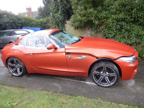

So she arrived on 31 December, very un-elegantly scraped off the transporter... luckily the front left wheel hung on to the car, so no further damage was inflicted.
I already have a problem - the battery is dead and there seems to be no connection to any main 12v battery in the boot / truck - my tester is not even showing zero volts! I've heard of the huge trouble to open the boot with no power, so that's my first task. My big concern is that the alarm will go off when I eventually get into the boot and get a new battery connected, as the key fob I have may have lost its programming. How long does the alarm go for - does it ever stop? Is there a way of hushing it? You can see the car is open, but I don't know if that was by the steel key or by the fob - if by key then presumably the alarm will blare as soon as it has power?
Also, the there is an "exploding" positive terminal on the battery, does that prevent the car from being jump started from the bonnet power points?
Also, clearly the car has the pedestrian protection and has fired the bonnet hinges up - can these exploded hinge attachments be removed (temporarily) so that it shuts better?
PS Someone helpfully took out any service documents and the wheel locking key (unless it is in the boot). She was previously registered as DR59... so it would be great if someone on here recognised it.
Pic attached - the scrape marks were made by the ramps from the transporter.
