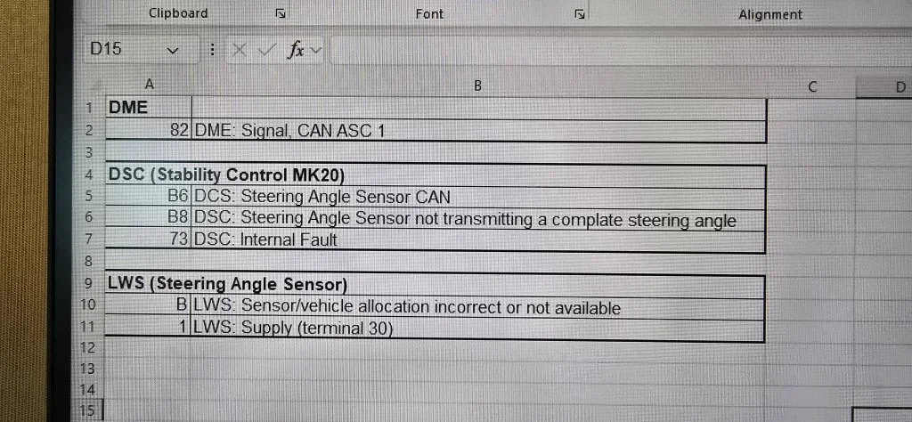

I love my Z3, but I do not love dash lights haha trying to figure out where to start on the pictured codes. Just received my cable and have INPA loaded onto the laptop. Pulled these codes with my Foxwell NT710 and the 20pin connector. My steering wheel is cocked slightky tonthe left, say at 11:30 or so FYI.
Here are my thoughts:
1: Check the steering angle sensor with INPA to see if it is reading.
2: Check wheel speed sensors with INPA to see if they are reading
3: If both are reading, have steering wheel reset to 12 o'clock with a euro car shop. Reset steering angle sensor (SAS) hope for the best
4: If a wheel speed sensor is out, replace, reset, hope for the best
5: if steering angle sensor isnt reading at all, unplug, clean plug, plug in, hopes and prayers
6: test SAS plug voltages (if there is one) and ensure it is getting power
7: replace SAS (ugh, I hope not) and reset, cross fingers and burn some sage.
Anyone else have any suggestions? Please and thanks!
