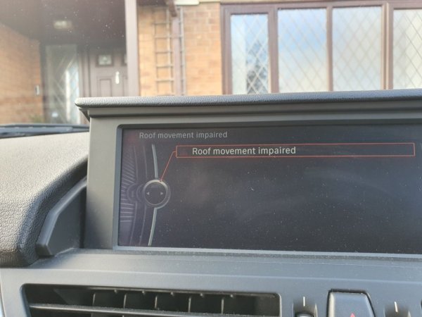

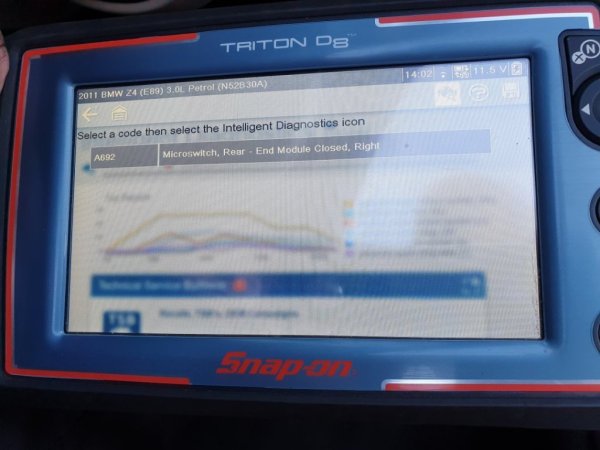

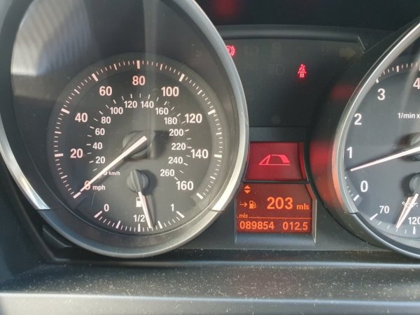

Hi, Rocky Dave was following me four months ago and noticed that the rear RHS indicator didn't seem as bright, checked it and all seemed good and thought nothing more of it, went around Europe and all fine. However, the roof has now closed but will not open. The display says 'roof movement may be impaired' & at 5mph+ says 'roof not locked' and starts to bong! Immediately thinks, micro switches, hall sensors or broken wires in the loom. A quick plug in and fault code A692 flags up - micro switch, rear end module closed, right.

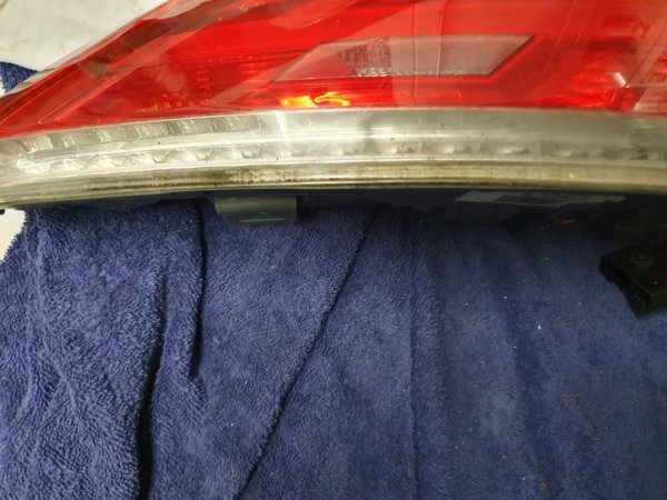

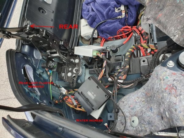

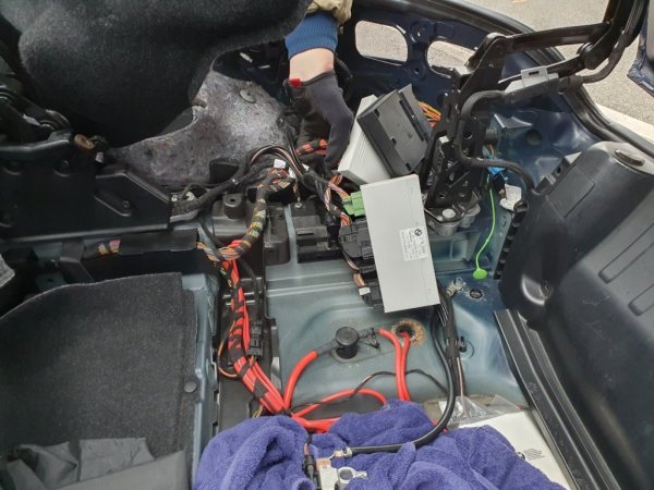

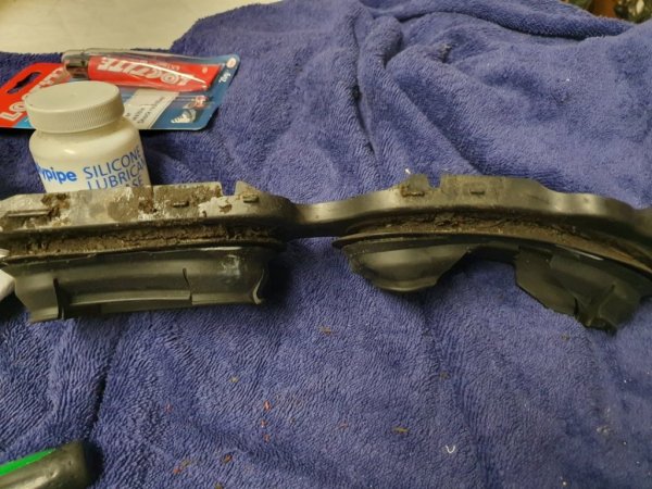

I was concerned about what was lurking in the boot right hand side, knowing that there lots of electrical ;bits' living in there, and also very much aware of the rear light cluster failing and therefore letting water in. Removed the RHS rear cluster to find exactly that, the lower seem had failed and come apart, also the rubber 'spectacles' seal was really gunked up with c**p and in turn has let water in!
Two options, either clean the seem perfectly and reseal, and obviously thoroughly wash the rubber seal, lubricate with silicone grease, or get a new good one from somewhere. As this is quite a common problem, I'm interested what your solution was if it has happened to you. Still got the roof problem, but kind of hoping that the electrics might dry out...but not holding my breath!
