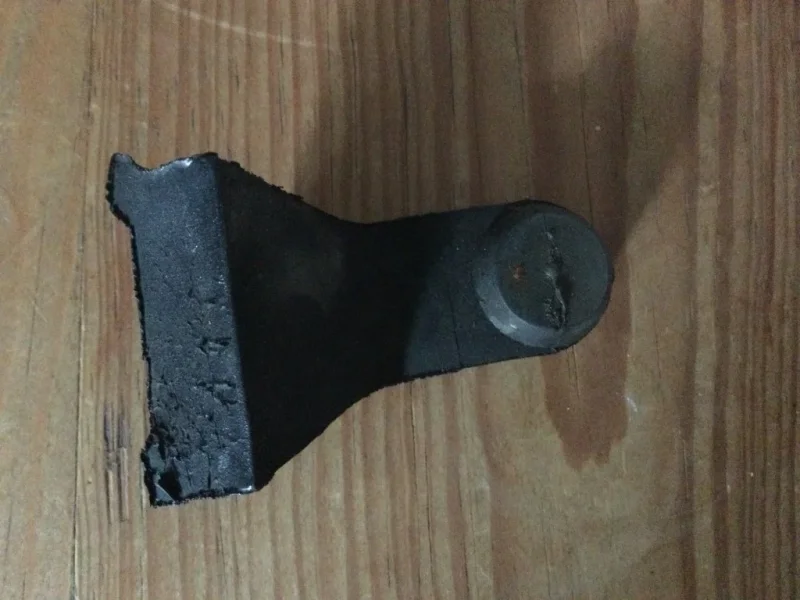

It’s close to MOT time so I cleaned and adjusted the handbrake, whilst there I noticed the driver’s side drop link has worked it’s way off the anti roll bar, it failed last year on this.
Any idea why it comes off and only the offside?

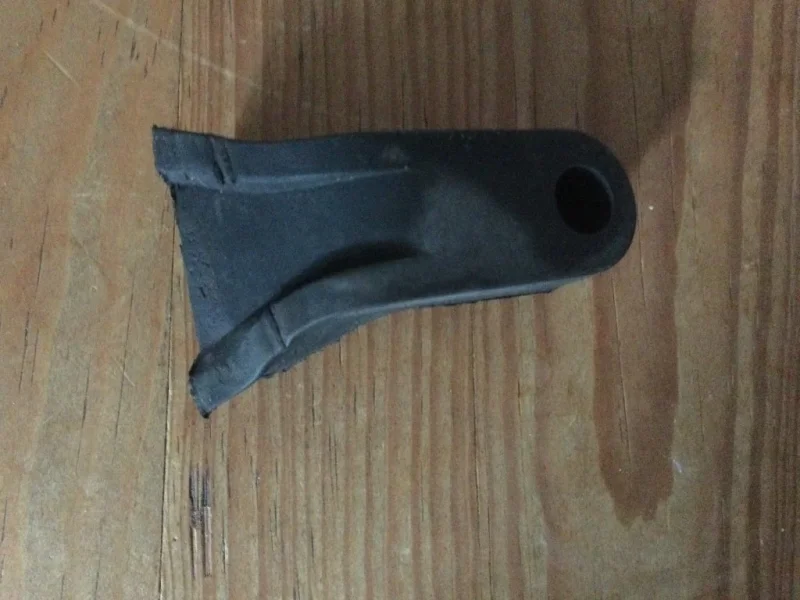

So back to the mystery part……. Had to pull the rear bar out to press the drop link back on and this appeared on the floor, anyone know what it is? TIA

Goes around the spare wheel carrier. Attached to the spare wheel carrier itself.

Brilliant thanks Lee , must have knocked it off wriggling the anti roll bar back in , although I never put the carrier back on when I rebuilt the back end .

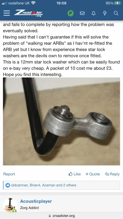

Hi. The ARB problem can be rectified by hammering a star lock washer onto the end of the ARB. if you can find my post of 28 December 2015 you will find a photo.

MOT tomorrow, will see what the tester finds , sort any other problems and get some star washers and have a go at this
