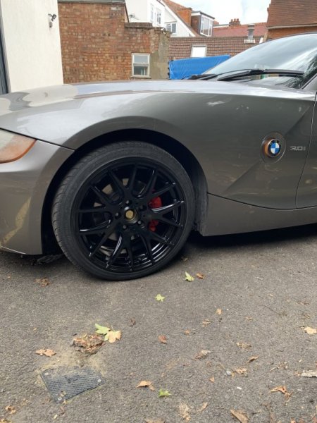

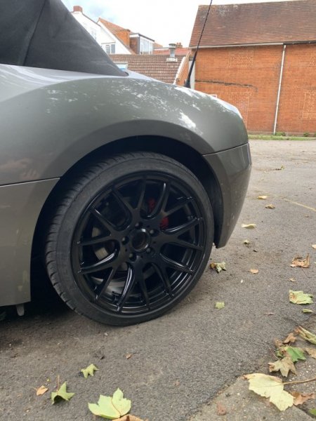

I purchased some lowering springs for my Z4 3.0i SE roadster as the stock (non-sport) springs were too soft for the track and the car sat a bit too high (the arch gaps were too much for a car like this). The springs are rated at 30mm, which was the only size available from 4 different manufacturers.
The little roadster now handles a lot better! However.....it now sits lower than anticipated, resulting in the front wheels hitting the inside the arches when going over the smallest of bumps and making a lot of speed bumps unbearable.
Has anybody else had this experience or any ideas on how to simply rectify without having to change everything again?
One idea I had was to change the spring pads to thicker ones, which will add approx 10mm.

Some photos would be useful.😀

I'll grab some photos of how it sits now when next see the car as it's kept elsewhere (not enough parking at home for all the toys :cool:).
But here are some with the stock springs (check that lean on the track).
