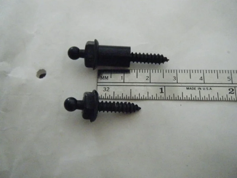

They are called Tenex fasteners. There is a button part that you pull up on and inside it releases two pieces. While still holding the button up, you place it on the ball shaped receiver, then release the button which lock it in position. Do not simply push down and expect it to catch.
The Tenex fasteners come in two lengths, short ones which are about 18mm long they are used to attach just the Tonneau cover and long ones which are about 27mm long to allow for a 12mm spacer which is used for connecting the factory mesh wind deflector. They are NLA (No Longer Available) from dealerships.

Tenex fasteners are available from suppliers. The spacer is easily made from a nylon or plastic spacer
