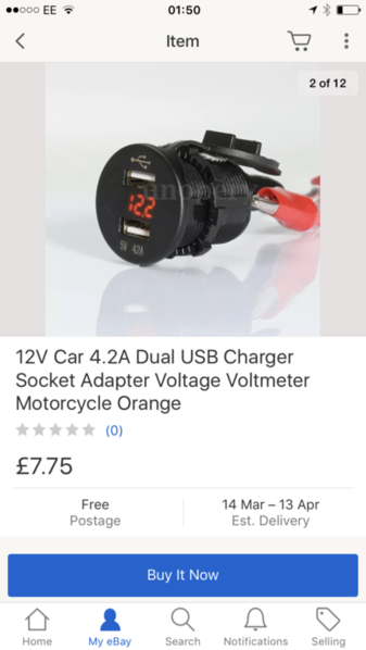

I like the look of those USB chargers @t-tony, links pls.

I've just picked one of these up which has the orange display
