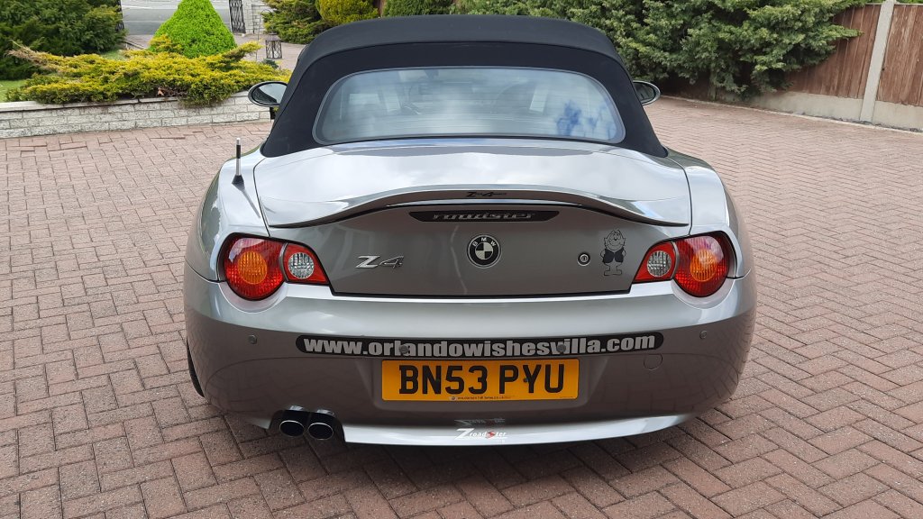

Exactly what I have on my Z4 with staggered 108 style wheels.
