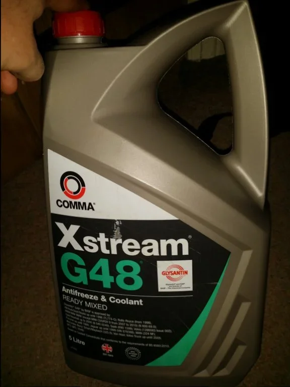

I put this from Halford's. Seems okay to me, just got what it said in the shop
