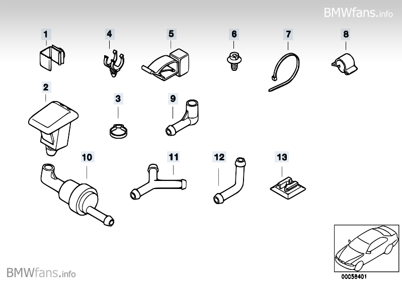

My drivers side (RHD) Sept 97 Z3 Washer is not heated as left the factory. The wires are there to connect so was at some stage. Been looking on ebay for a replacement but no joy. Are they unique to the Z3 or will other marques fit?
Many thanks
Andy
It's a common part for E36 and the Z3 :)
Part number 61 66 8 376 011 for the heated nozzle jet I believe.
Part number 2, click on the image and it will take you to the BMWFans page with all tHe part numbers on.
@Andy McDonnell could you let me know the cost if you are ordering please? JIM
@oldcarman spotted said part with correct part number as quoted by @Brian H on ebay. It also has the plug (which I don't need) and comes in at £34.97 + £9.16 postage as it's in the US. I'll hang slack for the mo.
