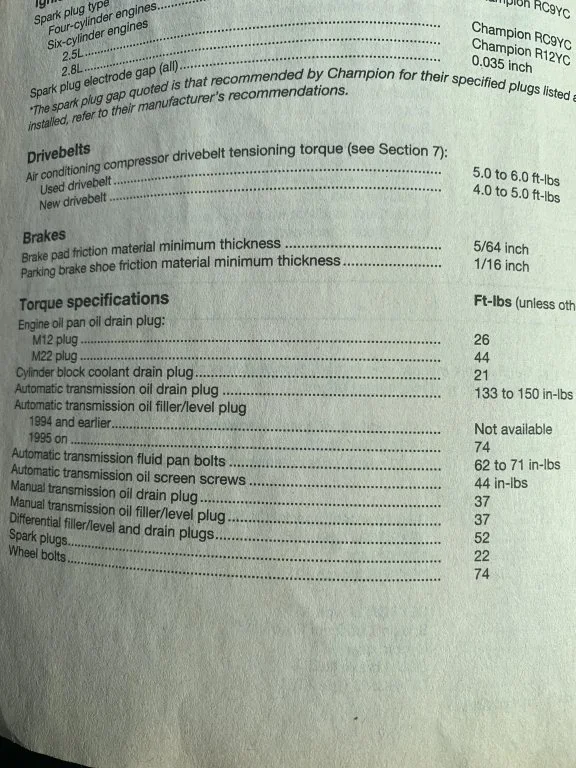

Z3Baddie
American Zeds
Sep 18, 2024
28
Long Island, NY
2.8 L ROADSTER
Thought I’d add the available general torque information from the Haynes manual. Hope it helps and adds to the existing post!
Appreciate the information! 💎
