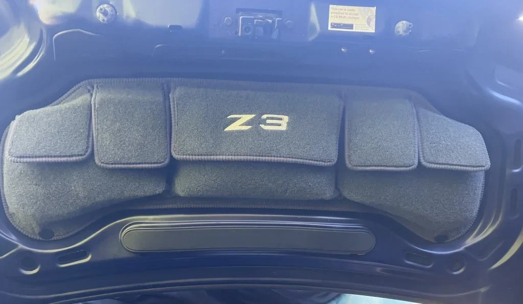

Anyone tackled the issue of damp in boot lid after cold nights.?.
Im considering adding some closed cell insulation, reading up it appears it'll be a barrier to the cold air accumulating overnight.
I'm going to give it a go overnight then take it off and see whats what, opinions??....

Old post here about fitting a liner to the boot lid, I put one in mine much the same as this one.
Ah great..cheers👌
