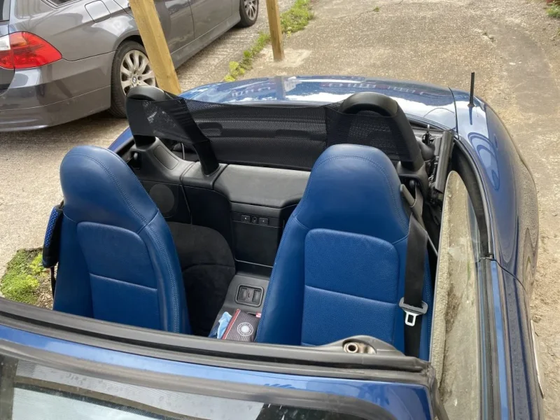

5: lift carpet on back shelf to find where the wires come in from the boot, this is where the new wires and hydraulic arm will has to pass through from the boot into the rear of the car. remove rubber protecter and open new holes for the new cables.
6: the motor needs to be mounted at a angle, then connect the wire cables, and then connect the earth cable, pass through the lifting arm and connector for the micro switch into the back of the car.
7: the connector for the roof micro switch is under the carpet behind the seat, you need to fit the micro switch to the roof, carefully secure the cables so they do not snag.
8: connect the lifting arm bottom first then lift the soft top by hand to connect the top joint, loosen the T switch on motor for Manuel roof lifting.
9: the up and down button connecter is at the back where the alarm light is, you can mount your button there. and you are just about done.

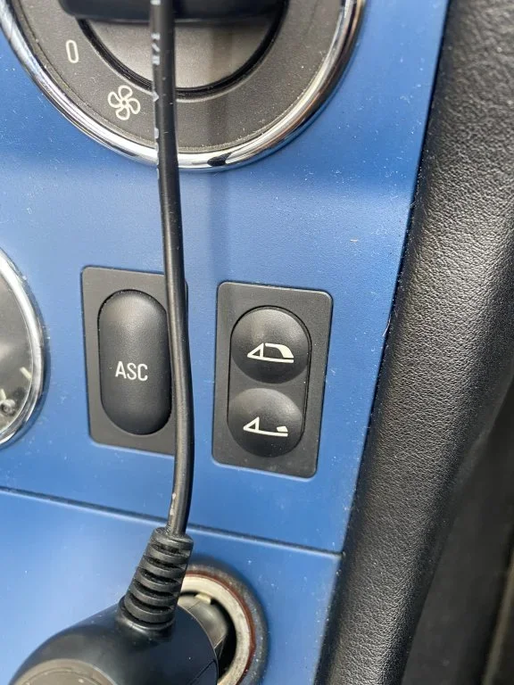

if you want the up/down button in your front panel of your car, it takes a bit of effort. you will need to pull (carefully) the cable from the rear, lifting the centre console and pulling it down the side to find where the wire goes, you will need to cut the cable shroud and carpet under the console (so it will not show) you will need to pull the wire so it will reach the front panel, wrap insulating tape around the wires you cut the shroud off, and put them back into their original place. remove the gear lever and surround and under surround as well, so you can thread the cable to the front panel. you can then choose where to fit your up/down switch.

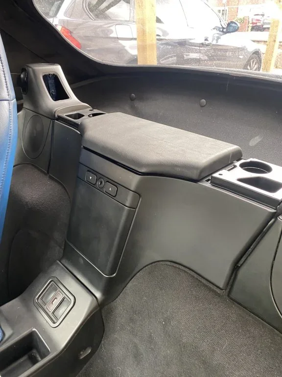

As a foot note (a spurs fan in a coupe) supplied me with some new boot carpet to fit the new roof motor, and get rid of the old cd changer carpet, as I did not get a cd change when I bought the car, I think it look much bigger and tidy.
