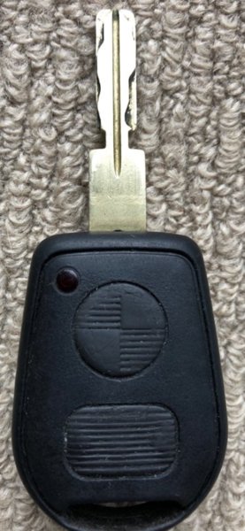

I have a 2002 Z3 Roadster originally imported into Japan and the exported to New Zealand when I purchased it.
There is a lot on forums on different sites about programming keys.
I have found the keys that come with my vehicle never need programming after a battery change or changing the batteries in the Key. It is a BMW key with Siemens electronics and has 2 x CR 2016 batteries running in series to make it work.
One key wouldn’t work so I removed the batteries and found one had 0.25v and the other 2.5v. New batteries are about 3.25v.
To my knowledge their is no alarm or immobiliser fitted in the car.
