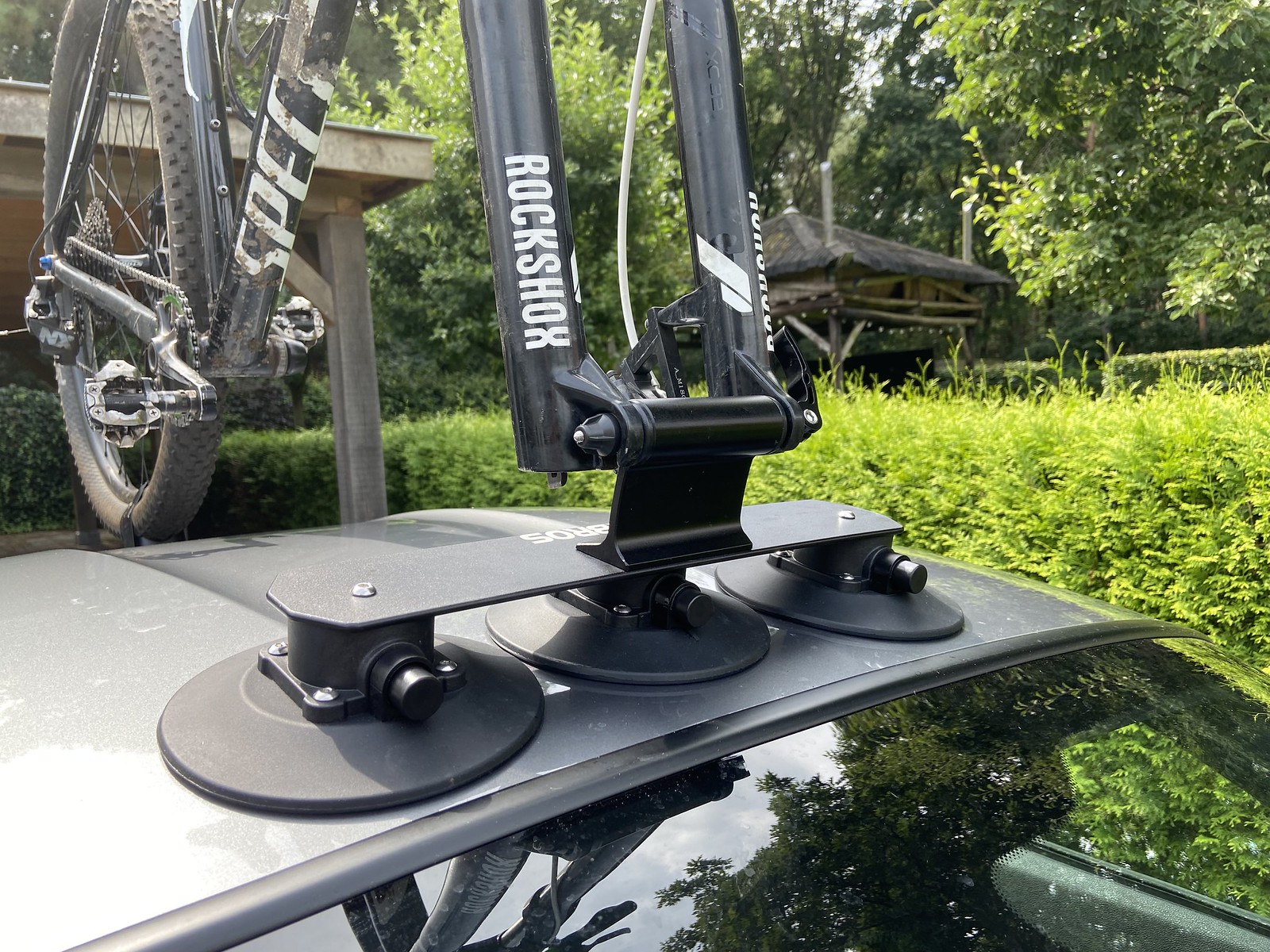

A while ago I happened to stumble across the "suction cup bike racks". I decided to test the version produced by Rockbros, rather than the one produced by SeaSucker as the Rockbros version is a lot cheaper and was available way faster. Rockbros' and SeaSuckers' products are shaped slightly different, however the principle is the same: (a) removal of your front wheel (b) three large suction cups in the front to which you connect your fork with either a quick release pin or a bolt through axle and (c) one large suction cup in the back to which you attach your rear wheel.

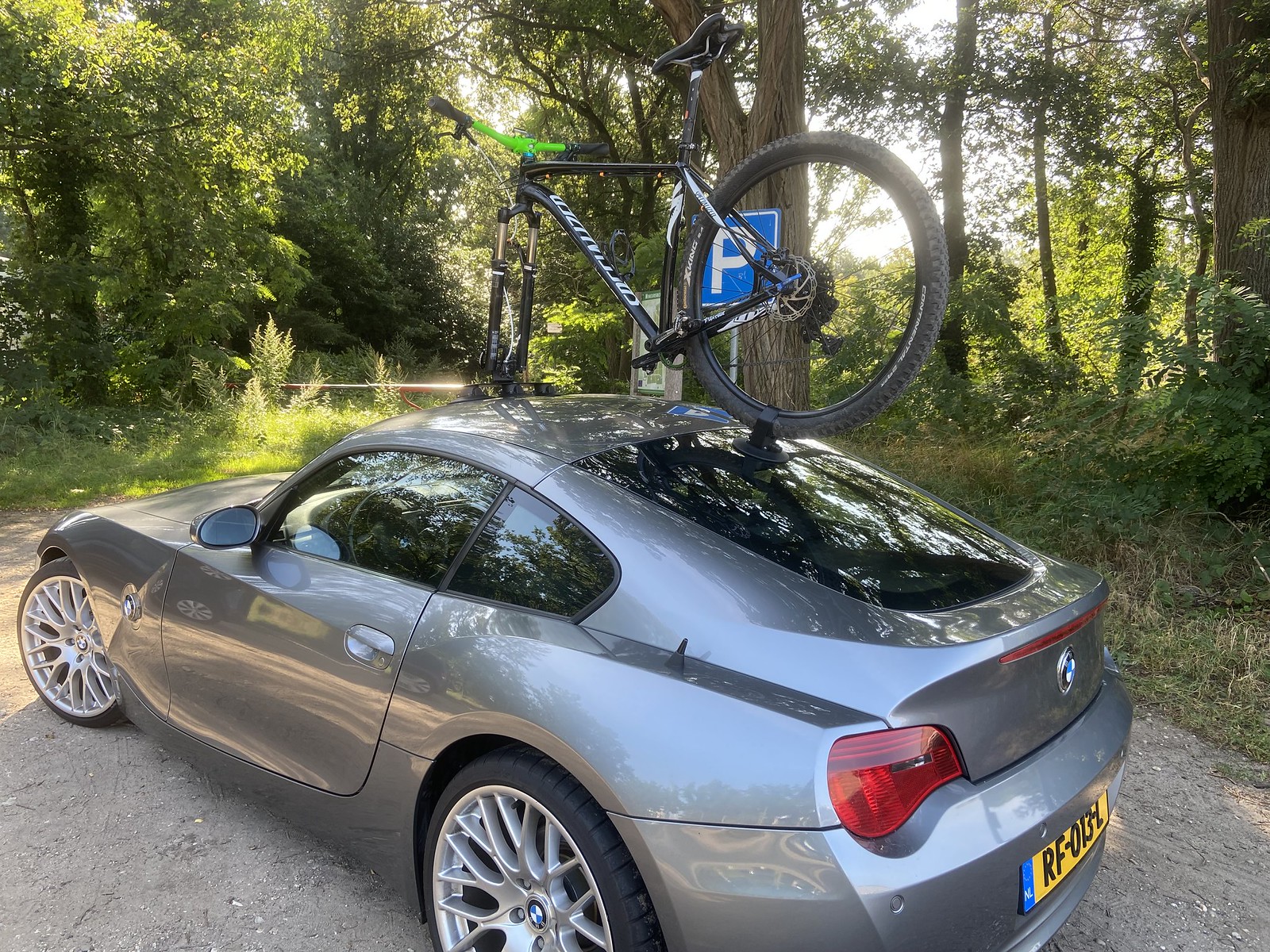

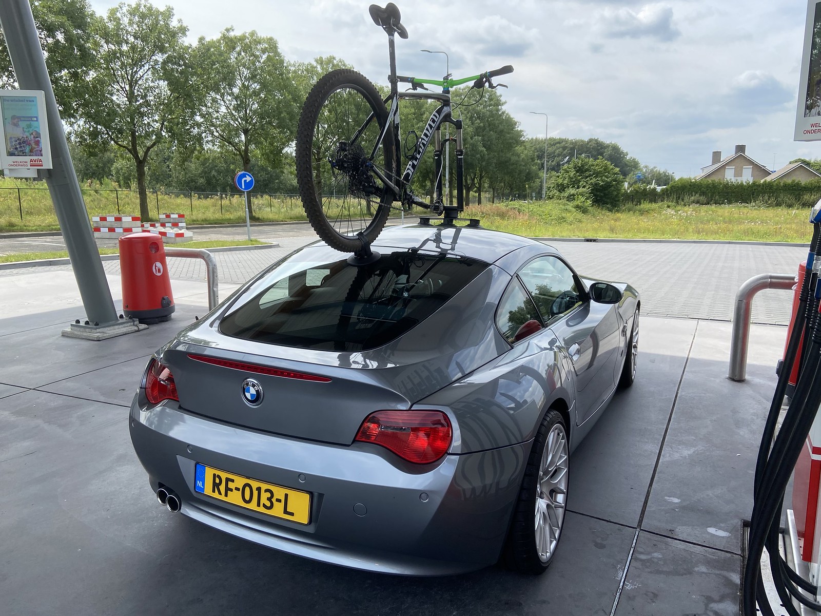

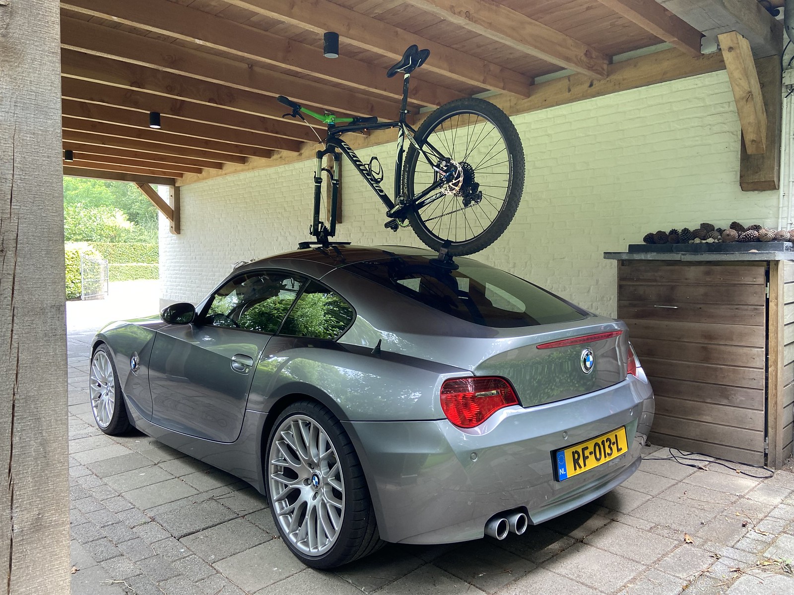

I had the same doubts as most of you probably will have but it really works a charm. Stopped four times in the first twenty kilometres, only to find out that everything was still rock solid:
Installs in five minutes and you can very easily check whether the cups have sufficient suction, because if not, a colored part of their plunger will stick out.

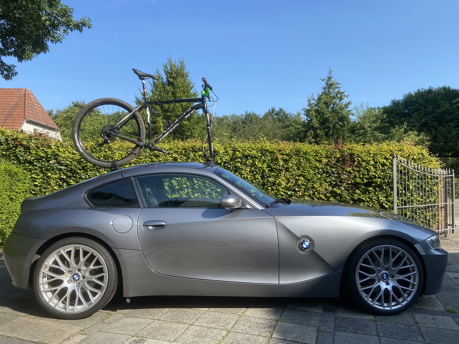

Thus: this makes me a happy chappy, as I can now use my coupe as a proper SUV.
By the way, I chose the one bike carrier. Rockbros also produces carriers for two and three bikes, each with more suction cups. However , I am afraid the roof is to convex for that many suction cups, as the aluminium bit is not that flexible.
