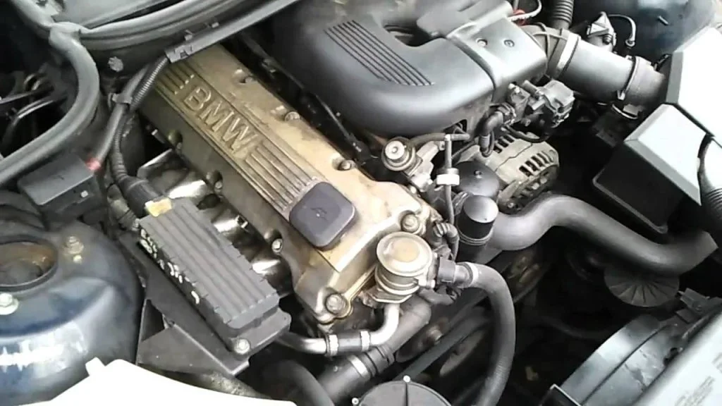

The earlier ones have the more powerful M44 unit which is 140 bhp and an easy way way to tell is that it will have a twin cam head with the plugs and plug leads in the centre of the valve cover under a black plastic cover like this.

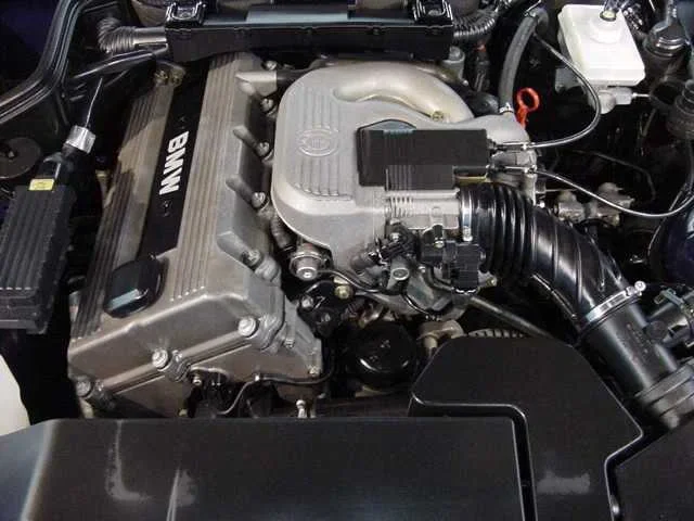

And the less powerful version will have a valve cover that looks something like this.

I think the less powerful engine is called the M43 on these engines it's always a good idea to change the coolant every couple of years as these are prone to head gasket failure if the coolant system is neglected

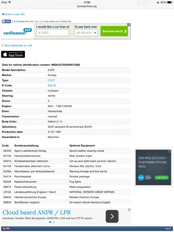

You can get a free bmw vin checker off the net and once you type in your details you should get an in depth description of the car and it look something like this and it should tell you the engine type

1999. Seems I have the less-powerful version.
