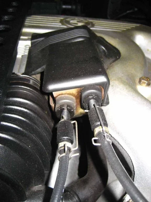

The bracket on the throttle for the two cables PN 41148401744 but then there must be a bell crank for the cruise control cable to attach to. Here's my bracket with the two cables entering - I could remove the black plastic cover on the throttle to show what happens beneath...
