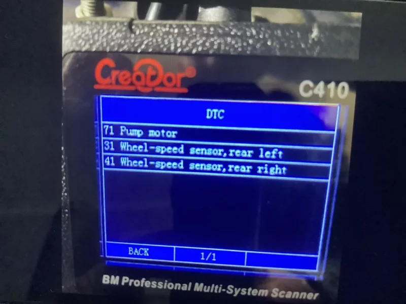

Hi, had these lights on and off over a period of a couple of years but now they seem on all the time.
my code reader shows
71 pump motor
31 wheel sensor left rear
41 wheel sensor right rear
i have removed and cleaned both sensors and connecting a test meter shows a reading so I guess it’s the code 71 pump motor that’s at fault.
just having a quick search and it’s shows an ABS pump and a electrical module attached is the pump motor the likely fault as the code suggests or is there a chance it’s the electrical module attached.

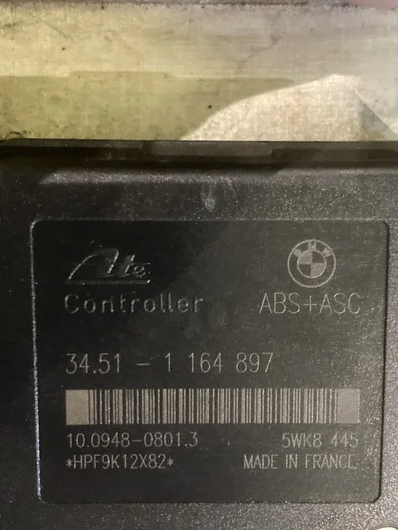

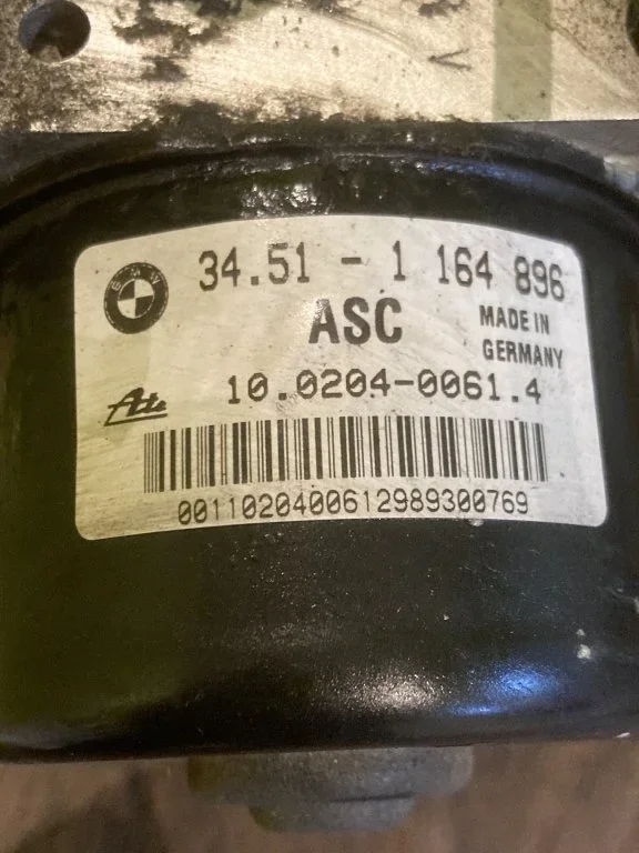

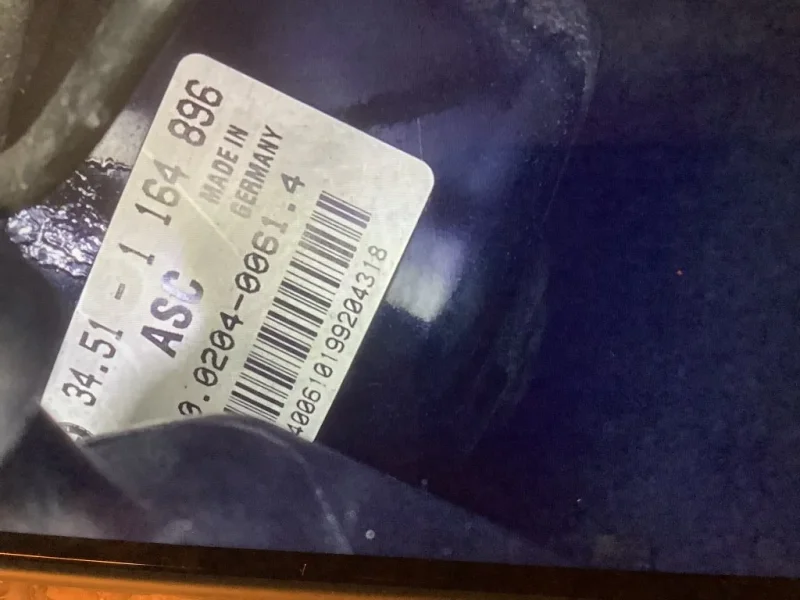

It’s a 99 model, this is the best picture I could get Of the pump.
Yep, it's 'that' one.
The ECU will have the same part number but ending in 7. (897)

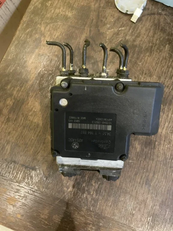

They're buggers for failing and I've fitted a few. They were used on E36's and earlier E46 cars. I have a secondhand one for £40 if you want to go that route.
