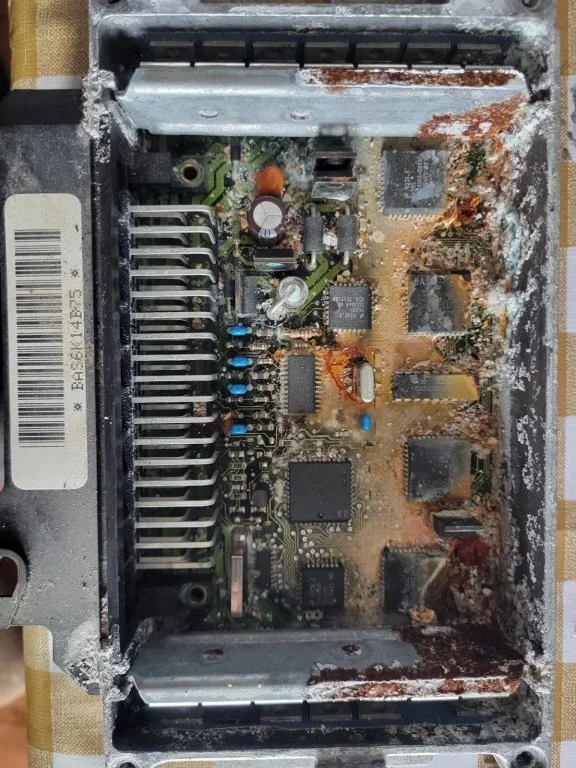

I purchased my 97 Z3 in July. It had water damage to the interior. Most of the repairs are done and the car has been on the road since mid August.
The ABS/ASC light have been on since I got the car. Because of the water damage, some of the module needed replacement. The ABS controller was severely corroded. I've installed a replacement and was able to turn off the warning lights, but after a test drive they came back on. A new scan indicates, among other things, that the "gearbox type wrongly coded." Also indicates that the ASC microprocessor is malfunctioning.
A bit of research tells me that this controller has to be coded to my car. This is new territory to me. I have downloaded the INPA software, but have no clue how to proceed. Is there a thread that can walk me through this procedure?

It's either another faulty unit or a different fault.

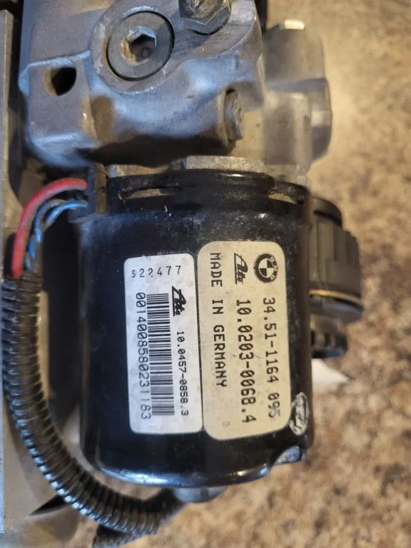

It would be helpful to indicate which engine and which ABS pump you have.
It's a 2.8l 5-speed. I've attached a picture of the ABS pump. This is a replacement part I decided not to install after I saw the condition of the control module, but is identical to the one in my car.
As indicated in my original post, it appears the module was pulled from an automatic. If it cannot be recoded, I may try to get another one that's verified to come from a 2.8 manual.

You probably have the 34521164094 ECU. Same as E36 323i 328i etc. They are prone to water damage from a windscreen leak.
