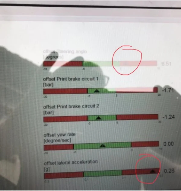

Sorry Zephyr I’m no tech, whats showing you there’s an issue with the sensor?
My version of inpa is mostly in German so no idea if theres a way of recalibration, anyone close to Bristol have a known Google one I could try before throwing more money away ?!!
These values are into the red area.
the steering is an easy fix as said above.
the lateral accelerator sensor could work if detached cleaned put back and reset.
i can not help with inpa, dont have the Z any more so can not plug it and take you step by step on the procedure. I am sure someone else in here either knows ze German, or has an English version. I am pretty sure it has a calibration/reset procedure, I have done it when my abs was on.

Will have another look when it stops raining, I actually unbolted both sensors, the small round one sent the straight line on the code reader all over the place when loose so whatever moves inside appears to be working ,yet you clear the fault and it comes straight back.
Just a quick update for those that gave some advice, put the lateral accelerator sensor that I got from ebay USA and with much messing around with INPA have now managed to clear the fault code and therefore the dash lights.
