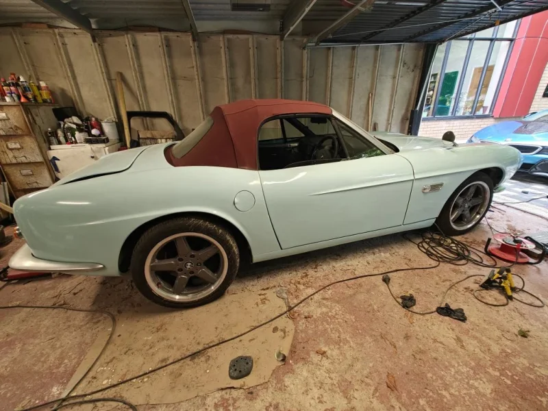

So I need to fasten the rubber boots to the jacking points - hopefully they'll hold the bottom of the sills in place. I have some temporary side repeaters to fit other than that I'm waiting on door handles then it's MOT time and hopefully get to drive it soon.
The jacking point boots won't hold the bottom of the sills.
Old steel sills do slide on either side of the jacking point. But the new GRP sills don't wrap under the car that far so don't get that close to the jacking point boot.
You'd need to use screws or something along the bottom of the sill. I'm using plastic trim clip rivet things.
Darn, I'll have to get under to have a look then

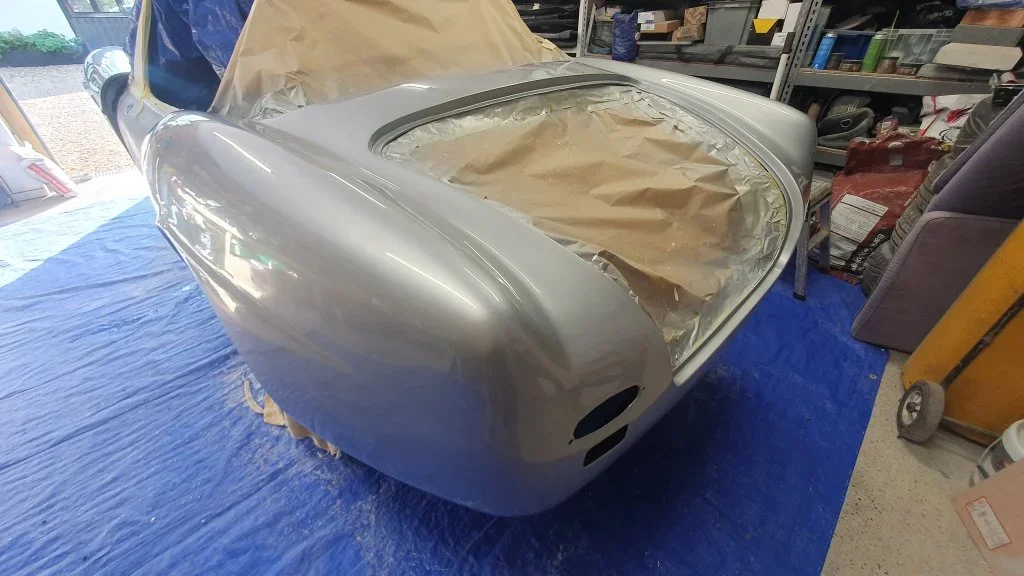

Wet flatting is knackering....800 where I have orange peel, then 1200, then 2000, then course polishing compound. Going to leave fine compound till it's assembled.
I've enjoyed learning to spray but it can be bloody frustrating in equal measures. I'm about to spray the passenger door for the 3rd time. Got a couple of small bugs in the laquer coat yesterday and thought I'd be able to wet flat snd buff them out.....nope 😒...start again.
I also have the lower arch below the swage lines on the clamshell (both sides to do)......this will also be my 3rd attempt.
1st attempt....1st laquer coat too heavy in those sections and it dragged the silver metallic down. 2nd attempt....better laquer coats but got a couple of runs. Ended up burning through to the base coat when sanding.....so start again 😖

I can not paint silver. Not sure why, but I’ve never had any success. Other colours have been fine, just not silver.

Had a result. Resigned myself to having to respray the door because of the bugs. Hit it again this morning with 800, 1200 and 2000 and managed to buff the bugs out so no need to re do.
Still the front wing bottoms to do but need to watch a few YouTube videos to get a rolled masking edge 1st 😂
Have to say, I'm loving the silver metallic. Was a bit apprehensive due to needing a drop coat before laquer......but many YouTube videos watched have helped 🤣🤣

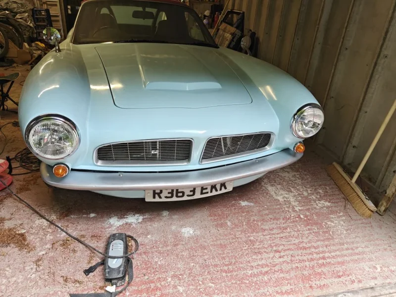

Ok, so done something with the bumpers:
Door handles and then MOT, then endless sanding to go
