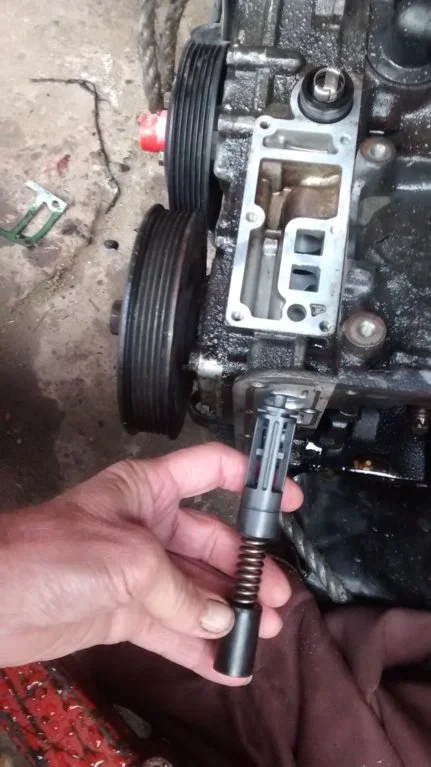

Decided to drop sump and check oil pressure relief valve to find it stuck open and solid, needed a blind bush puller with slide hammer to withdraw it. Was full of crud and being plastic had crud embedded in the plastic jamming it. Full clean out and new valve fitted with nice sliding fit. Checked for pressure by fitting spare gearbox on to which the starter mounts, cranked engine on floor to see oil exiting cam spray bar - result!!

The new oil valve assembly being fitted.
Cleaned up oil filter housing, valves cleaned out also.

Anyway the point of this tale is do not ignore your oil and filter changes, unfiltered oil circulating the system through the by pass valve due to a blocked filter ends up delivering crud where you don't want it - in this case jamming the relief valve open killing oil pressure. When it happened I don't know, was it just coincidence it happened when it did? There was certainly pressure before albeit only run a minute as no coolant in engine. No damage appears evident, no nasty noises and only a low mileage car to boot.
