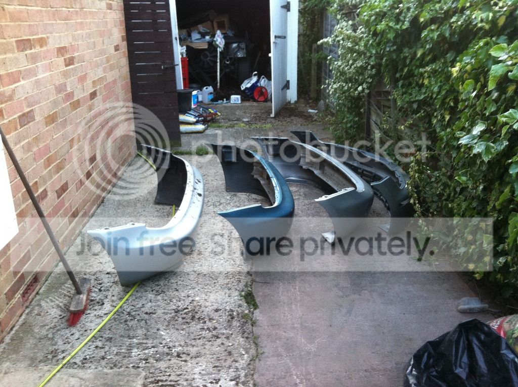

Family party this weekend, so been told to tidy up, by this I guessed the back of the garden store of Z3 parts was deemed unacceptable.
So my growing collection of Z3 bumpers has been moved, however there is a point to my post!

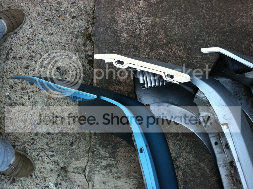

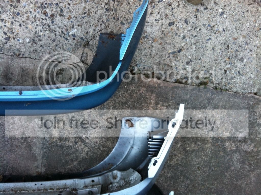

While laying them out I noticed the distinct difference between narrow and wide body rear bumpers.
Just thought that someone on here may care?!?!?!
Atlanta Blue is 1.9 narrow body prefacelift
Silver is 2.0 wide body (prefacelift I think)
You can see the width of the bracket mount showing on the silver widebody bumper just how much wider it is.
As all Z3 rear bumpers fit any model (unless you fit a standard to an ///m (which would hit the quad exhaust on the drivers side)) the mounts have to be in exactly the same place.

I didn't think all Z3 rear bumpers did fit all cars Andy, I thought it was only the front bumpers that did this?
You've made be think now, too late for that really!
I think all rear bumpers fit, but the rear wings and some sills wouldn't meet as you'd expect. So technically no it wouldn't fit, but would go onto the mounts.
I think!
I think!
If I can be arsed, I'll test out my theory tomorrow, I'm not short on Z3 carcasses!

Ahhh, yes the mounting points must be the same but the bumper will not line up withe the rear wings etc.

Yes all bumpers will fit, but if you don't change the rear wings then you will have a 40mm gap, I know this having done the wide body rear conversion...nice bumper collection btw...
