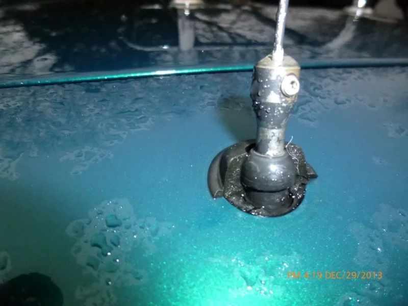

Went out in the rain to take a picture. Set a pen next to it for a perspective of size. I had thought that it was broken in half, however upon closer inspection, it may not be broken or ripped at all. I thought half of it was missing, but it may be that the half that is there is on the high side of the slope or curve of the body and may act as a shield for water. What do you think?
These two didn't come out so clearly.
My assistant wants to be fed.
Looking at the picture Frankie I don't think the aerial you have screwed in is an original one by any means. Does it unscrew out of the lower black section which it should. The rubber section which does look as though half is missing is the grommet which can be picked up from eBay for a few quid (dollars in your case) but check with you BMW dealer as the ones for sale over here on eBay are more expensive than the ones from the dealer and as said there are slightly different versions depending on your body style. The original antenna that screws in can be picked up very cheap on eBay and are 16" long as standard with a spiral wire bound whip.

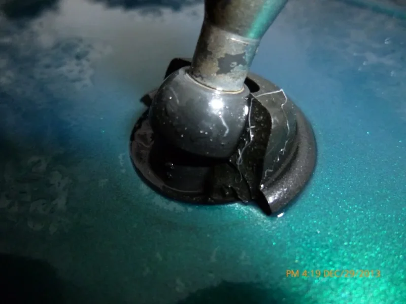

I took another look at the antenna and took more pictures. Its still raining but not as much. It is broken. It seems that the rubber is one piece and is pushed up through the hole from the bottom and may be held in place either by the pressure of the rubber, which could be possible because of the small mass of the antenna or is actually held in place by some tightening device from underneath. I wasn't able to see because of the rain. Here are the pictures:

OK that aerial has to go it is absolutely awful, it should just unscrew from the base if you grab it and twist. As regards to the base if you remove the boot lining inside the boot and unbolt the hydraulic softtop pump placing it to one side you will see the actual aerial base bolted in position. It is held in with one bolt/nut which when removed will allow you to withdraw the base downwards, there is also a rubber gaiter on the inner wing but you will get the gist when you do it.
Here is a link to a UK eBay link of the grommet which with the aerial base removed can easily be fitted from above just make sure you get the right one for the narrow body wing.

Also check in inside the rear wing well when you remove the softtop pump (if yours is electric of course) as I would edge my bets it will be full of water considering the condition of that aerial grommet.
Here is a link to Realoem which shows you a diagram and part number (item 5) for the Grommet.
http://www.realoem.com/bmw/showparts.do?model=CH73&mospid=48091&btnr=65_0284&hg=65&fg=30
Just cross referenced the part number and it appears it is the same grommet for all Z3's whether they are narrow or wide bodied but I too thought there was two versions so best check with your dealer before you order one but as you can see they are only a couple of dollars so peanuts to change.
