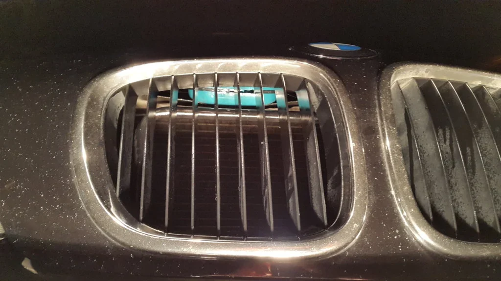

As per title, the handle in the car has plenty of tension but it just doesnt seem to release the bonnet...
Any suggestions?

I think the bodyshop has left a screwdriver under the bonnet, there is what looks like a green handle when i looked through the left kidney grille

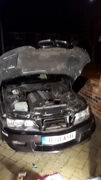

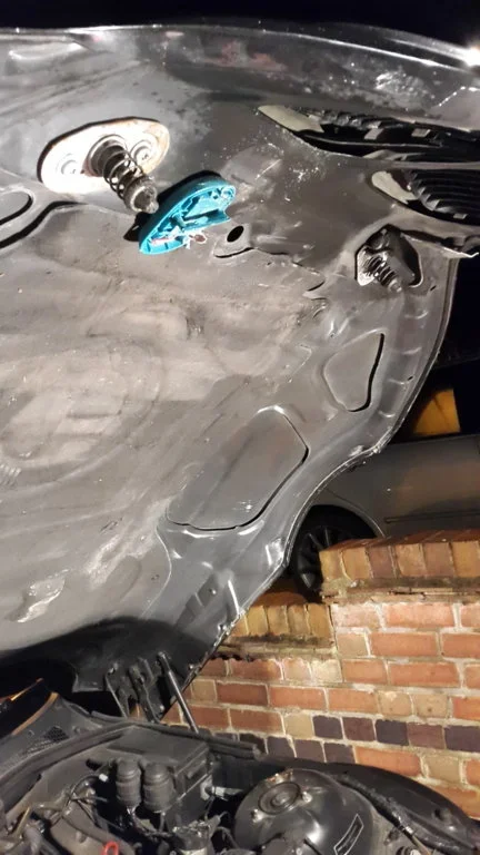

Used a screwdriver, mallet and drill combination to smash the green thing apart and still needed to man handle the bonnet to get it to release!
It was a magnetic torch, part of it remained in place lol
I have saved the remains to show the bodyshop tomorrow :mad:
