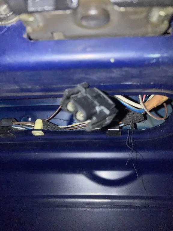

I'm sorry, I don't recall the colour, however there is a small access panel on the inside of the boot lid, pop that out and you'll see the connector for the lock actuator and that will tell you which ones to focus on.

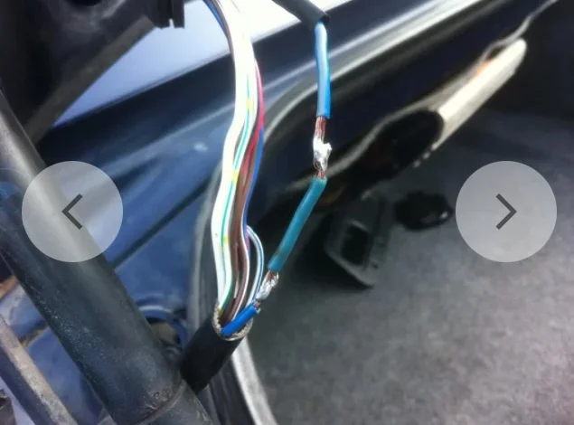

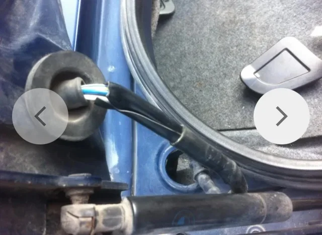

Based on the pics in this this thread - it's a White/Blue or Blue Grey (one pic appears to me from my car in 2013 as duplicated below)
It seems to happen at the bend inside the loom where the clip supports the loom (between the body and the lid).

But look at link above. I seem to have the exact same symptoms as Richardix - and he had a torn blue wire.
Am I missing something?
Also based on the following thread - it seems that most likely it is another case of loom gloom.

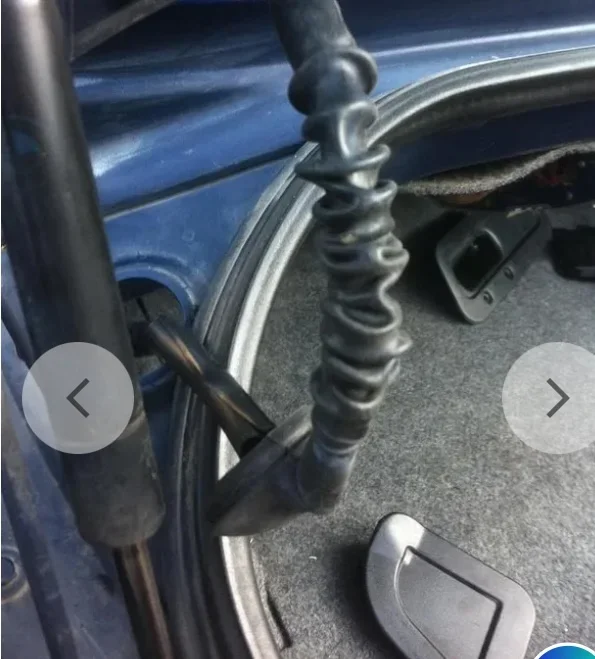

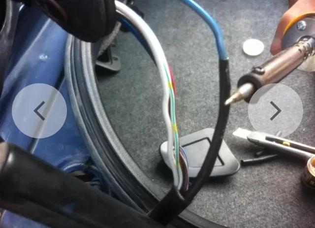

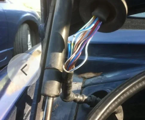

Seems I did it 11 years ago 🫣 then it was Blue/Gray wire…
Recovered pics from years ago (not in order) 😎

Is there a straightforward way to test the actuator before I order another?
The plot thickens - I’m not getting a 12v pulse to the actuator connector when I activate the locks.

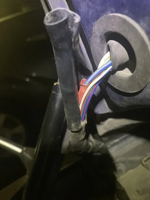

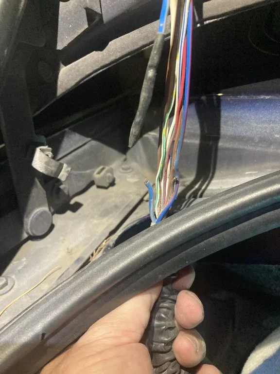

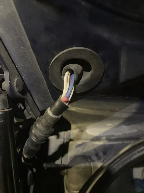

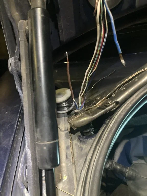

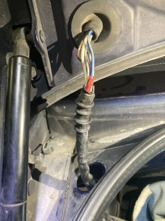

Ok - as expected - was the blue/gray again. I was able to peel back the outer sheath (I heated it up with a blow dryer) without damaging it. Replaced the splice I did 11 years ago.
It seems the manufacture of that wire was problematic. I also removed the inner black sheath as it is now very rigid and could be the cause of the problem (perhaps it was soft 28 years ago).
Pics below (not in order) similar to 11 years ago. The last pic is what I found when I opened up. (Tip - it is clear that this time the break was at the edge of the last solder fix. Next time it happens I will replace a section of the gray/blue wire such that the the two soldered joins are outside the loom)
Took only an hour (after establishing earlier that the problem appeared to be the blue/gray in the loom)
