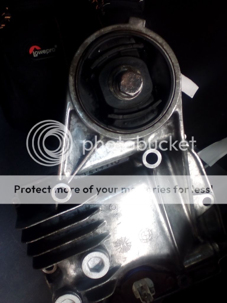

You can do it without removing the spare wheel5 minute job 1le of castrol syntrax 75w-140 remove spare wheel as long as car level just 2 hex nuts ...dont be tempted to over fill

I am now a bit puzzled as just about to order both but Tis sheets show for my 2.2Hi @Davyhoogy apologies I forgot I said I would post some info after I had done mine.........i did but on my progress thread "made a start today"..
Gear box oil 2 litres Redline D4 used 1.5 litres approx. Has made gear changes smoother and the box quieter.
Diff oil 2litres Castrol syntrax 2 litres and it took just about all of it.
Got mine from @oilman Opie oils.
Hope this helps.
Steve
